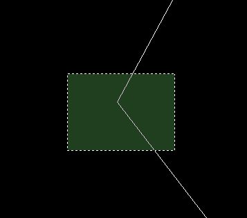

Hi. I am using this code to dimension the out angles of a polyline.Is it possible to update the code to work for polylines and lines? Now work only for polylines. If i have two lines i can not dimension the out angle.

You will need to write a new selection method, something like a window 1st cnr implies the side of the angle, as its a small box can uses ssget "F" and look at what is crossed is it a pline or 2 lines.
