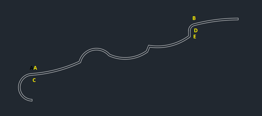

lrm
There are several problems with the geometry that are making it difficult to convert it totally to a closed polyline.  There are gaps in the profile at "A" and overlapping line/arc segments at "B", small (0.0025) jogs at "C" and "D, and an extraneous vertex at "E".  Some of these problem could be fixed with zero fillets or chamfers or join with a fuzz factor but some would not.  I think it would be better to explode the entire outline to lines and arcs and closely examine the noted problem area endpoints for gaps and overlaps and fix them before converting to a single polyline.  Depending on the downstream use of the geometry you may want to consider deleting the upper half and use offset to create a new version based on your fixed bottom profile.  Also, is it important that adjacent arcs are tangent?  If so they aren't at A or B for example. You may want to also fix this.
