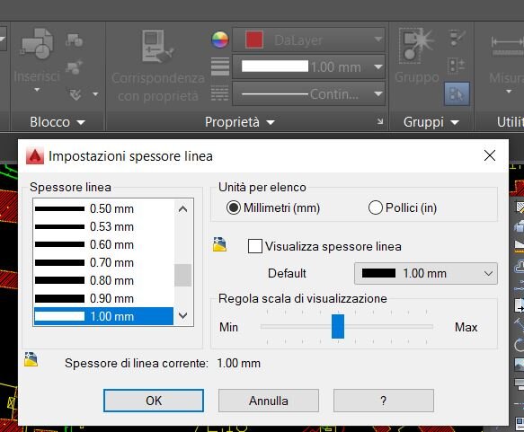

Giovannino60 Posted March 22, 2021 Share Posted March 22, 2021 How should I proceed to see the thickness of a polyline. If I click on Line thickness setting and click on display thickness, I see on the screen both the thickness and the polyline I am constructing and all the lines already made, instead I want to see only the polyline I am constructing by 1 mm. Thank you Quote Link to comment Share on other sites More sharing options...

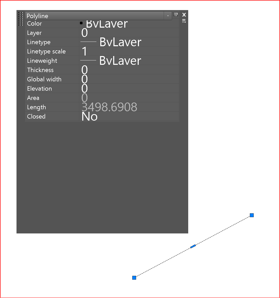

BIGAL Posted March 22, 2021 Share Posted March 22, 2021 If you have Properties displayed you can see width and change. 1 Quote Link to comment Share on other sites More sharing options...

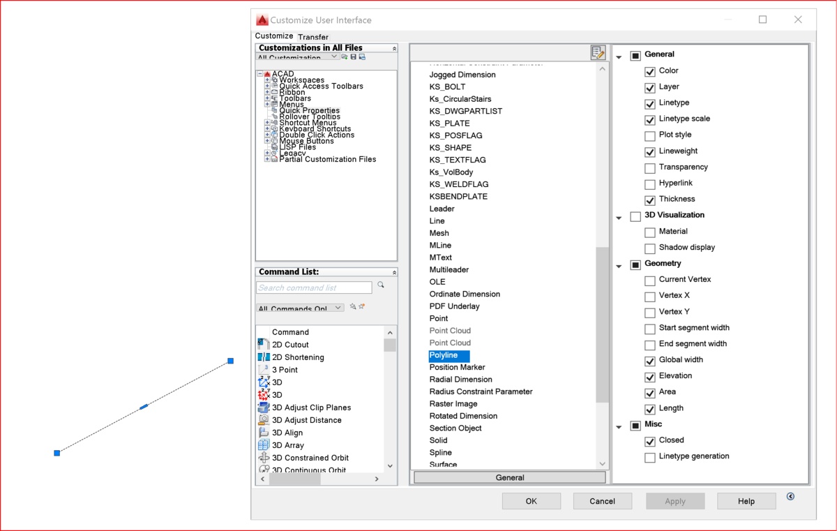

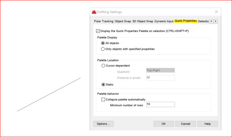

Dadgad Posted March 23, 2021 Share Posted March 23, 2021 (edited) @BIGAL has used Properties which are the most universally comprehensive way to go. Personally I am a big fan of Quick Properties, as shown in the screenshot. The difference is that Quick Properties displays less information, but because it is user customized, it likely provides more Focus for an individudal users personal needs and kinds of work. A great tool, but one needs to fine tune it first, to make sure that information displayed suits ones own needs. As needed the full Properties display is always available as a backup, should more information be required than is your personal norm. In Drafting Settings functionality can be further personalized as shown in the last screenshot. #QuickProperties Edited March 23, 2021 by Dadgad hashtag added Quote Link to comment Share on other sites More sharing options...

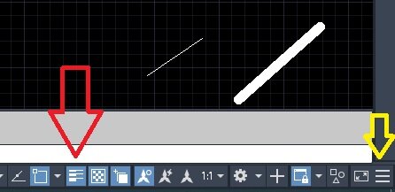

steven-g Posted March 23, 2021 Share Posted March 23, 2021 Your dialogue box is for lineweight, which is different to thickness and width. To see the lineweight you need to highlight the icon shown with the red arrow in this image, if you don't see the icon you can make it visible by clicking on the 3 horizontal lines (yellow arrow) and select line weight. 2 Quote Link to comment Share on other sites More sharing options...

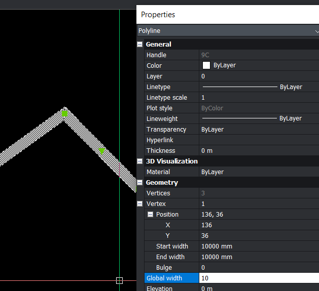

ReMark Posted May 25, 2021 Share Posted May 25, 2021 ONE polyline? Use the PEDIT command and the WIDTH option. Quote Link to comment Share on other sites More sharing options...
Dana W Posted May 25, 2021 Share Posted May 25, 2021 (edited) On 5/25/2021 at 6:28 AM, Giovannino60 said: I was just asking how to visualize the thickness of one of a polyline and not a normal line? Thank you You are very welcome. But you showed us a picture of the Lineweight dialog box... I see the problem. Thickness translates to spessore in Italian, and that is what your Lineweight dialog box is labeled with. Unfortunately Thickness in AutoCAD is used for what we think of as height in English, something else altogether. In English, all three words, Width, Thickness, and Weight can also mean how wide something is. No wonder my Italian girlfriend was always mad at me. I thought she was just hot headed. Check the box that says Visualizza spessore linea, OR click the task bar icon that steven-g referred to. Both can be turned on or off at will. Remember, the screen representation in modelspace is not true to scale, but the paperspace display is very very close to scale, limited by pixel size. If you still can't see the lineweight in modelspace, then adjust the slide bar, Rigola scala di visualizzazione. Google translates lineweight (one word) to spessore di linea which makes things worse. Thickness is a 3D property, the vertical (Z axis) height of an individual 3D object. Thickness can be but is not necessarily a property of an individual polyline. Width is a 2D and 3D property, the actual width in units applied to an individual polyline. If you add both width and thickness to a polyline you have an object with three dimensions. Lineweight is a property applied to 2D and 3D objects which will result in the "thickness" of a printed line or polyline. Now it's time to go listen to Morgan James sing "All About That Bass" which also has a lot to do with "Thickness" You will have to search her up on Facebook Watch or YouTube. The song I refer to is a cover of a Morgan Trainor song by an ensemble called Postmodern Juke Box. It's a fun tune, but when Ms James lets go, the hair on your arms will stand up. Her power and range is worth interrupting this thread for. She is astounding. When you are done with that song, move on to her covering "Dream On" by Steven Tyler & Aerosmith. Then the hair on the back of your neck will also stand up, and you will think she is from another dimension. Edited May 26, 2021 by Dana W Quote Link to comment Share on other sites More sharing options...

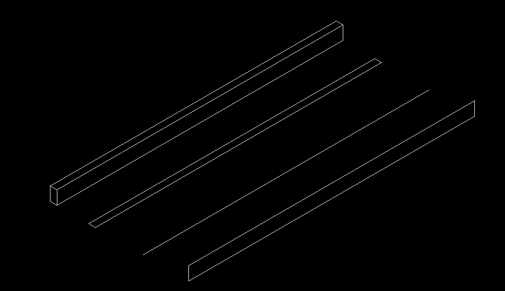

BIGAL Posted May 26, 2021 Share Posted May 26, 2021 Same pline copied with various thicknes, width and linetypewidth Quote Link to comment Share on other sites More sharing options...
