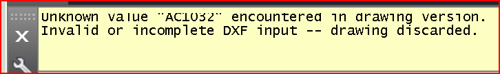

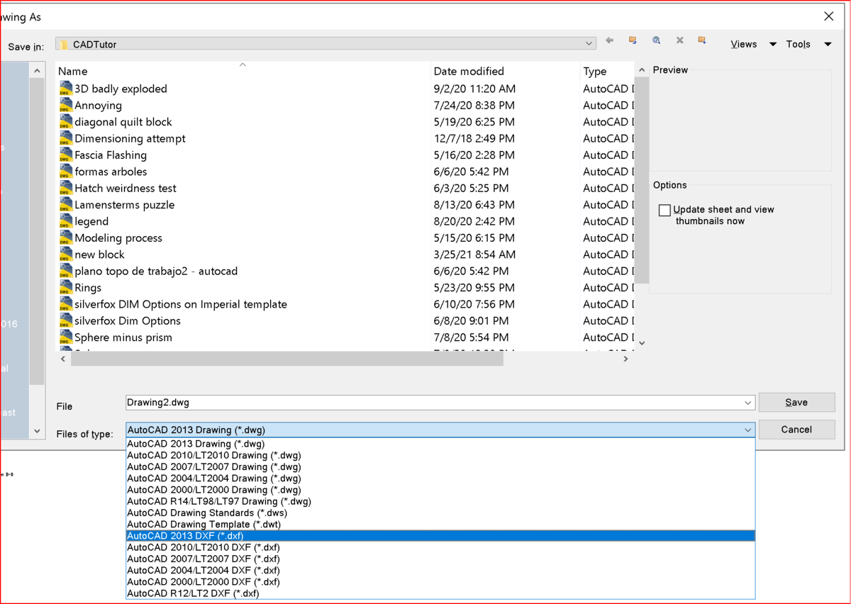

Dadgad Posted March 29, 2021 Share Posted March 29, 2021 (edited) I am using Autocad 2016, perhaps if you saved it as 2013? This is the message I get. You might try adding some more points to the spline as you create it, which makes it easier to reshape after the fact with the STRETCH command, by selecting the appropriate grips with a crossing selection window. Edited March 29, 2021 by Dadgad screenshot added Quote Link to comment Share on other sites More sharing options...

JoeS09 Posted March 29, 2021 Author Share Posted March 29, 2021 hi Dadgad, I have saved the dxf file in 2013 format, please see attached Spline test_2013.dxf Quote Link to comment Share on other sites More sharing options...
