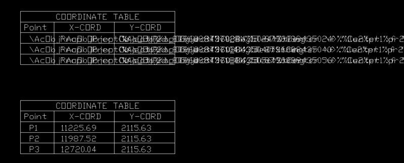

Hi to everyone
i use lisp to link mtext by field
the problem is that it not show me the text
only after i click the text it work
even "updatefield" not working beacause its not recognized it at field
i add the part of the lisp and the dwg
anyone can help me?
			(entmake 	(list
							(cons 0 "MTEXT")
							(cons 100 "AcDbEntity")
							(cons 100 "AcDbMText")
							(cons 10 (nth 2 nks))	; First Insert point
							(cons 40 TxH)			; Text size
							(cons 50 0.0) 			; rotation
							(cons 1 (strcat "%<\\AcObjProp Object(%<\\_ObjId "
										(itoa (vla-get-ObjectID (vlax-ename->vla-object (entlast)))) 	">%).TextString>%"))

mousho
hi tharwat
my field structure is right
the problem is that i need to "_mtedit" to see the field value and not the string
see pic above

mousho
hi thrwat
i did modify the code accordingly and it work for most of the code
the provlem is with that line
Quote
            (vla-put-textstring (vlax-ename->vla-object str)
the entlast should be the earliear picking and not the last.
how can i select the last TEXT or the entlast before?

Tharwat
As long as you selected the Text entity earlier so that means you already have it assigned to a variable, so use this variable instead of the function 'entlast' that you used into the field codes.
You can post your codes if you are not able to solve this minor issue.

Tharwat
Here is an example to work with the selected Text object and not Mtext object.
(if (and (setq txt (car (entsel "\nSelect Text object :")))
         (or (= (cdr (assoc 0 (entget txt))) "TEXT")
             (alert "Invalid object. Try agian.")
         (setq pnt (getpoint "\nSpecify insertion point for Field : "))
         (setq str (entmakex (list '(0 . "MTEXT") '(100 . "AcDbEntity") '(100 . "AcDbMText")
                                   (cons 40 12) ;; (cons 40 TxH) ; Text size
                                   (cons 50 0.0)
                                   (cons 10 pnt)
                                   '(1 . "")
  (vla-put-textstring
            (_Get:Object:IdString (vlax-ename->vla-object txt)) ">%).TextString>%")
(defun _Get:Object:IdString (o / u)
  ;; _Gile
  (if (vlax-method-applicable-p (setq u (vla-get-Utility (vla-get-ActiveDocument (vlax-get-acad-object))
        'GetObjectIdString
    (vla-GetObjectIdString u o :vlax-false)
    (itoa (vla-get-ObjectId o))
