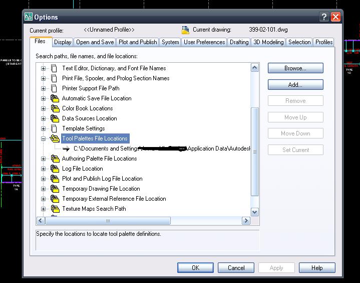

I've seen a problem resulting from installation. If you set it to import settings from previous version it may still pull from the previous version's directory instead of the current. If you did this, double check the full path of the tool palette target folder, they are nearly identical except for the a2009/a2008/etc.. part.
