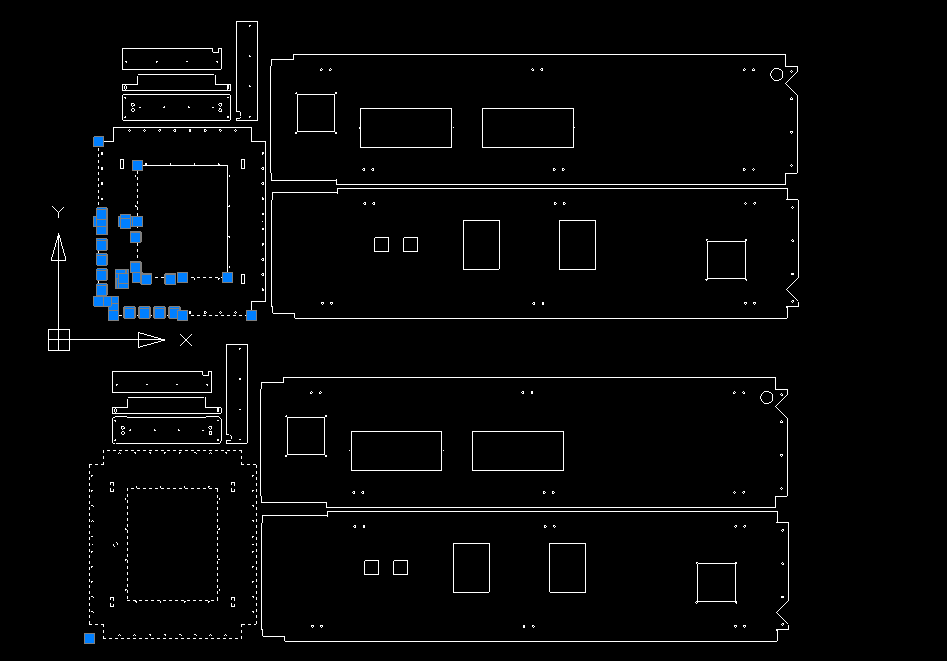

I have a dwg file from others, there are sheet metal parts' flat pattern, I wants to covert each part to a blocks in its position, like Ctrl + C, and Ctrl + shift + V, move the block to the old position, and delete the old lines. There are too many parts in it, I hope there will be a lisp doing the job.
Any help would appreciate. Thanks.

I think the difficulty lies in how to choose a complete profile. Kind of like the hatch command, find the outline and all the elements in the outline.
testBlock.dwg
Edited by brent_bai
Use the Join command. this will make everything polylines. then use the following on the perimeter to select it and everything inside.

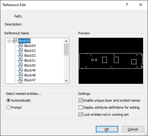

I have test your lsp file, it worked. Only one problem left: I need to select the profile one by one to create the block. Usually there are more than 500 parts in a drawing like this, which is a lot of work. Anyway thank you!
The issue is the fact that your outlines have buldges. Now if all segments of the polyline outside was straight, it could be accurate and I would know how to do the whole lot in one shot. But judging by your drawing, it won't be much effect.
This is why its important to post all relevant information.
1 Create a new temp layer and draw a rectangle around all geometry you want to block. (better if you use a different color so its easier to see)
2 Use the boundary command and on the island option pick outer. (see attached drawing)
3 Delete the large rectangle and run this ab command. (still needs  the Set_BlkName lisp)
One problem with this
All the original perimeter polylines are not in the block. These should be deleted. overkill mabye?
Also if you don't mind spam take out the nomutt lines.

Just now, brent_bai said:
Dear mhupp, Great job!
I tested your lsp, it worked for me. Thanks a lot!

@mhupp @brent_bai How about this? (with thanks to Lee Mac's Outline Objects routine)

Edited by Jonathan Handojo
I Tried his lisp but it outlines everything and you just want to outline the perimeter so you can use the ssget "WP"
Your lisp has alot of nested blocks. That code is so over my head i don't know even where to start.
Your lisp is probably better suited for Brent If he is using it like I think he is. Laying out parts to be cut on a machine he doesn't want to wonder if he selected all the internal geometry. So moving blocks around takes the guess work out of it. Just remember to explode everything twice and you should be good to go.
Edited by mhupp
@mhupp Your new lsp can not be loaded, error : bad argument type <"BLOCK"> ; expected <STRING> at [setvar]. I try your last lsp by your steps, it worked in BricsCAD, sometimes does not work in other CAD software. I tried the join command and boundary command to create the outline, sometimes it will fail to create polylines by unknown reason. I can't find the cause. The dwg file exported by SolidWorks, I checked there is not tiny gap between lines. Thank you all the time!
@Jonathan Handojo Thank you! Your lisp is suited for me. It not work in NanoCAD (free version), it tell me "error: invalid SSGET mode string", may be the software version is too low to support ssget method. But it worked in BricsCAD(trail version), I will come to the company to test your lsp by ZWCAD2021 on Monday. Thanks.
