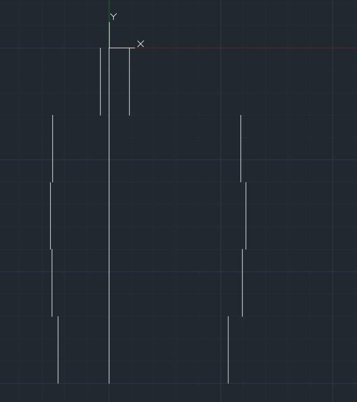

When I draw a using script:
_LINE 0,0 @30<90 X
_SELECT L
_OFFSET T M 30 -100 E
_UCS @30<90
The result of offset is different every single time, and it's often nowhere near the input value. I am really desperate here...Output of the command run 5 times is attached. I found out that the input is based on the position of cursor, but there seems to be no way to disable the bloody thing. Any clues please? I have thousands of values, there is no way I can input them all manually.

SCRIPT
Command: _LINE
Specify first point: 0,0
Specify next point or [Undo]: @30<90
Specify next point or [Undo]: X
Point or option keyword required.
I managed to substitute the use of offset with rectangles. Offsets simply didnt work for me.

offset with rectangles , if it are polys is easy , get the rectangle lenght , then offset , way you want, if you want to OUTside, the new poly's lenght  SHALL be  great than the original poly , othertwise it went to INside
By teh way I hada not see any rectangle at your sample
Please upload a sample .dwg with such rectangles and teh way you need to offset
