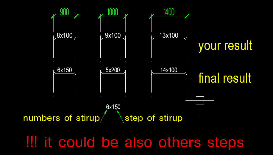

sergiu_ciuhnenco Posted May 13, 2021 Share Posted May 13, 2021 Test1.dwg Need help with checking the multiplying of numbers is equal with the dimension Quote Link to comment Share on other sites More sharing options...

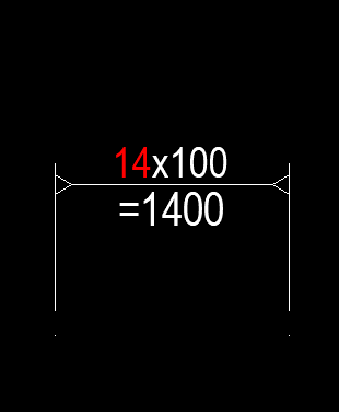

sergiu_ciuhnenco Posted May 13, 2021 Author Share Posted May 13, 2021 Hi Ronjonp !!! to go with your Ideea : just rewrite the dimension with corect number (red number) 14x100=1400 So if we have a dimension 1400 and step x100 => 14x100=1400 Quote Link to comment Share on other sites More sharing options...
ronjonp Posted May 14, 2021 Share Posted May 14, 2021 (edited) Like this? (defun c:foo (/ o s) (if (setq s (ssget ":L" '((0 . "dimension")))) (foreach e (vl-remove-if 'listp (mapcar 'cadr (ssnamex s))) (setq n (/ (vla-get-measurement (setq o (vlax-ename->vla-object e))) 100.)) (vla-put-textoverride o (strcat (rtos n 2 0) "x100")) ) ) (princ) ) Edited May 14, 2021 by ronjonp Quote Link to comment Share on other sites More sharing options...
sergiu_ciuhnenco Posted May 14, 2021 Author Share Posted May 14, 2021 Hope you understand te ideea Thnaks in advance !!! Quote Link to comment Share on other sites More sharing options...
ronjonp Posted May 14, 2021 Share Posted May 14, 2021 Code updated above .. only does x100. 1 Quote Link to comment Share on other sites More sharing options...
sergiu_ciuhnenco Posted May 14, 2021 Author Share Posted May 14, 2021 yes, work perfectly for x100 step, Is it possible for to be in one lisp incuded all the steps : 60, 70, 75, 80, 90, 100, 150, 200 Quote Link to comment Share on other sites More sharing options...
BIGAL Posted May 14, 2021 Share Posted May 14, 2021 (edited) This is a slight change to what Ronjonp provided. (defun c:foo (/ o s spc) (if (setq s (ssget ":L" '((0 . "dimension")))) (progn (setq spc (getreal "\nEnter spacing eg 100 ")) (foreach e (vl-remove-if 'listp (mapcar 'cadr (ssnamex s))) (setq n (/ (vla-get-measurement (setq o (vlax-ename->vla-object e))) spc)) (vla-put-textoverride o (strcat (rtos n 2 0) (strcat "x" (rtos spc 2 0)))) ) ) ) (princ) ) If you have fixed values could do like this can have more values its a library routine. 3 lines of code to make. Edited May 14, 2021 by BIGAL 1 Quote Link to comment Share on other sites More sharing options...
