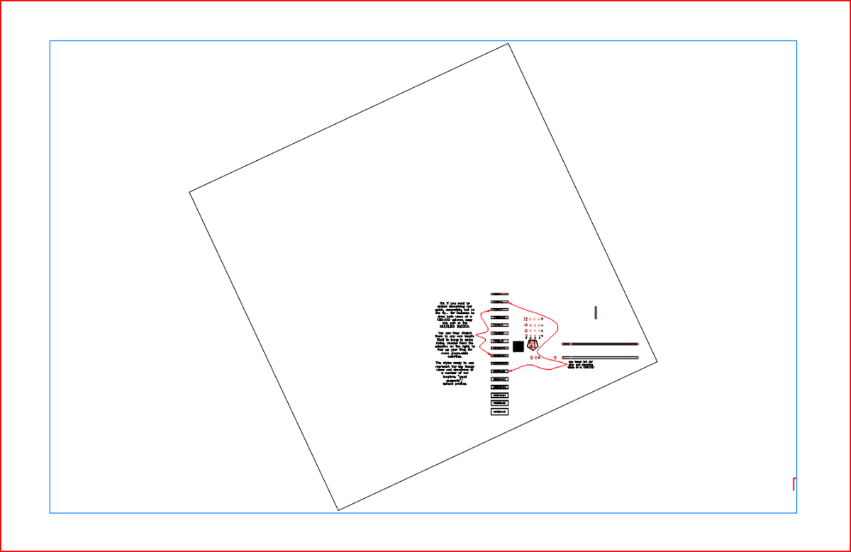

What if the view was linked to a single block which was a bounding rectangle, wherever this went the viewport would follow.
I dont think you can do this auto update. If say one block or a block with a attribute say layout number then run a lisp and would update. still thinking about it.
Post a sample dwg with say 2viewports and 2 blocks.
