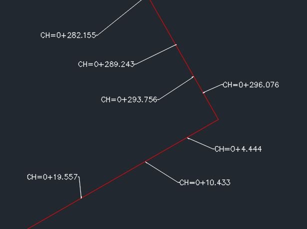

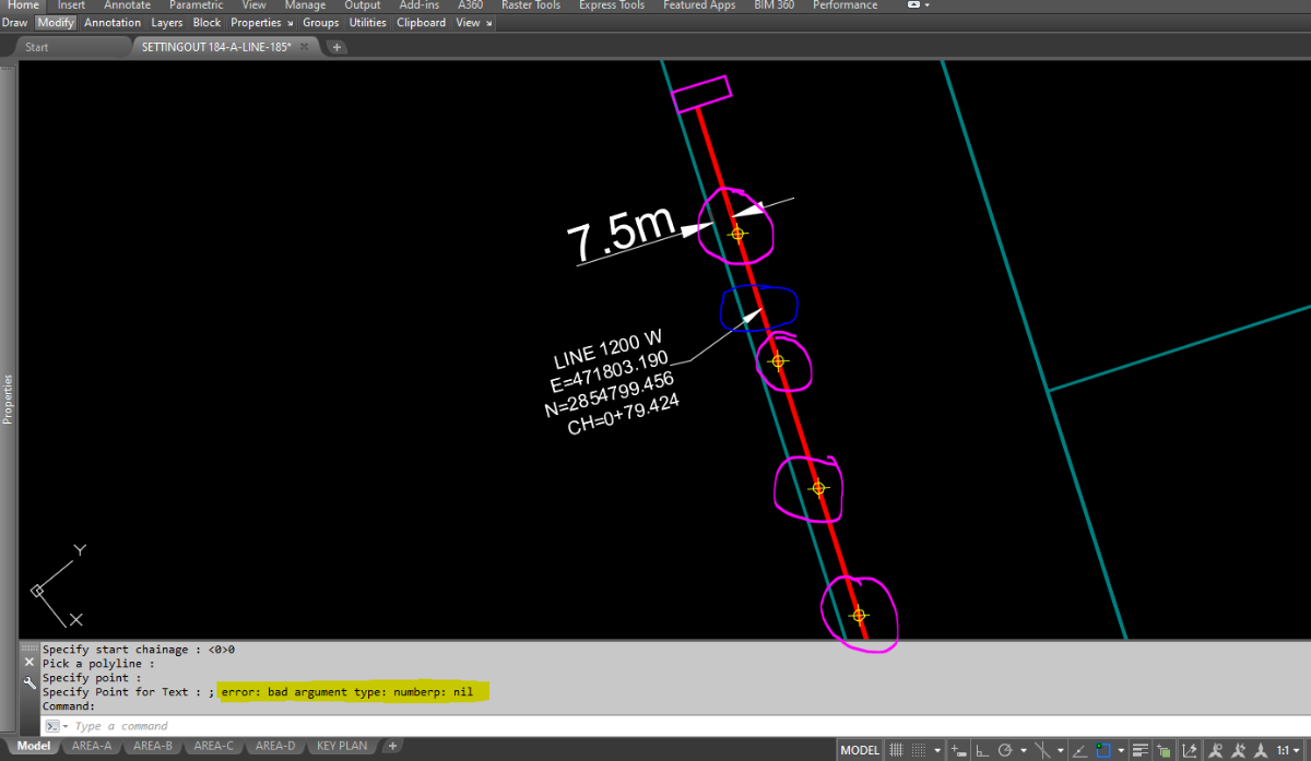

minejash Posted June 5, 2021 Author Share Posted June 5, 2021 its not working as i wanted, but its giving output, Thank You. i have a lisp code here, its working in polyline but not points above it. when i use measure command to the polyline, the points are created . when i pick the points to get the chainage ,its showing error. is it possible to get polyline length even if i click the points above it? Please check if possible. other than that the lisp is working wonderfully. hak_vz helped in it. (defun c:CE (/ s p c tp sch f) (setvar "cmdecho" 0) (setq sch (getstring "\nSpecify start chainage : <0>")) ;"0" is set as the default value (if (= sch "")(setq sch "0")) (if (and (setq s (car (entsel "\nPick a polyline :"))) (or (= (cdr (assoc 0 (entget s))) "LWPOLYLINE") (alert "Invalid object! Please pick a polyline only.") ) ) (while (and (setq p (getpoint "\nSpecify point :") ) (setq c (vlax-curve-getclosestpointto s p)) (setq tp (getpoint "\nSpecify Point for Text : ")) ) (setq di (vlax-curve-getdistatpoint s p)) (setq f (fix (/ di 1000.0))) (setq di (- di (* f 1000.0))) (command "_.LEADER" p tp "" (strcat "CH=" (itoa (+ (atoi sch) f)) "+" (rtos di 2 3)) "" ) (vlax-put-property (vlax-ename->vla-object (entlast)) 'height 0.60);;; Text Height 0.60 ) ) (setvar "cmdecho" 1) (princ) ) Quote Link to comment Share on other sites More sharing options...
hosneyalaa Posted June 5, 2021 Share Posted June 5, 2021 1 hour ago, minejash said: its not working as i wanted, but its giving output, Thank You. i have a lisp code here, its working in polyline but not points above it. when i use measure command to the polyline, the points are created . when i pick the points to get the chainage ,its showing error. is it possible to get polyline length even if i click the points above it? Please check if possible. other than that the lisp is working wonderfully. hak_vz helped in it. (defun c:CE (/ s p c tp sch f) (setvar "cmdecho" 0) (setq sch (getstring "\nSpecify start chainage : <0>")) ;"0" is set as the default value (if (= sch "")(setq sch "0")) (if (and (setq s (car (entsel "\nPick a polyline :"))) (or (= (cdr (assoc 0 (entget s))) "LWPOLYLINE") (alert "Invalid object! Please pick a polyline only.") ) ) (while (and (setq p (getpoint "\nSpecify point :") ) (setq c (vlax-curve-getclosestpointto s p)) (setq tp (getpoint "\nSpecify Point for Text : ")) ) (setq di (vlax-curve-getdistatpoint s p)) (setq f (fix (/ di 1000.0))) (setq di (- di (* f 1000.0))) (command "_.LEADER" p tp "" (strcat "CH=" (itoa (+ (atoi sch) f)) "+" (rtos di 2 3)) "" ) (vlax-put-property (vlax-ename->vla-object (entlast)) 'height 0.60);;; Text Height 0.60 ) ) (setvar "cmdecho" 1) (princ) ) REPLACE THIS (setq di (vlax-curve-getdistatpoint s p)) WITH THIS (setq di (vlax-curve-getdistatpoint s c)) 1 Quote Link to comment Share on other sites More sharing options...
minejash Posted June 5, 2021 Author Share Posted June 5, 2021 Thank you. it works well now... Thanks Quote Link to comment Share on other sites More sharing options...

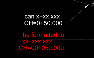

CADWORKER Posted June 6, 2021 Share Posted June 6, 2021 Its a great code, Thanks all for this. I have a small request to make can the text be further formatted to 00+000.000 instead of 0+00.000 Thanks in advance Quote Link to comment Share on other sites More sharing options...

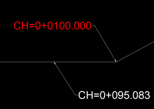

hosneyalaa Posted June 6, 2021 Share Posted June 6, 2021 1 hour ago, CADWORKER said: hosneyalaa, thanks for your help. But its not showing any difference in results. And REPLACE (strcat "CH=" (itoa (+ (atoi sch) f)) "+" (rtos di 2 3)) With (strcat "CH=" (itoa (+ (atoi sch) f)) "+0" (rtos di 2 3)) Quote Link to comment Share on other sites More sharing options...
CADWORKER Posted June 6, 2021 Share Posted June 6, 2021 22 minutes ago, hosneyalaa said: And REPLACE (strcat "CH=" (itoa (+ (atoi sch) f)) "+" (rtos di 2 3)) With (strcat "CH=" (itoa (+ (atoi sch) f)) "+0" (rtos di 2 3)) Here the values less than 100 are good, but 100 and above are not true... please look into this.. Thanks for all your time and efforts.. Quote Link to comment Share on other sites More sharing options...
