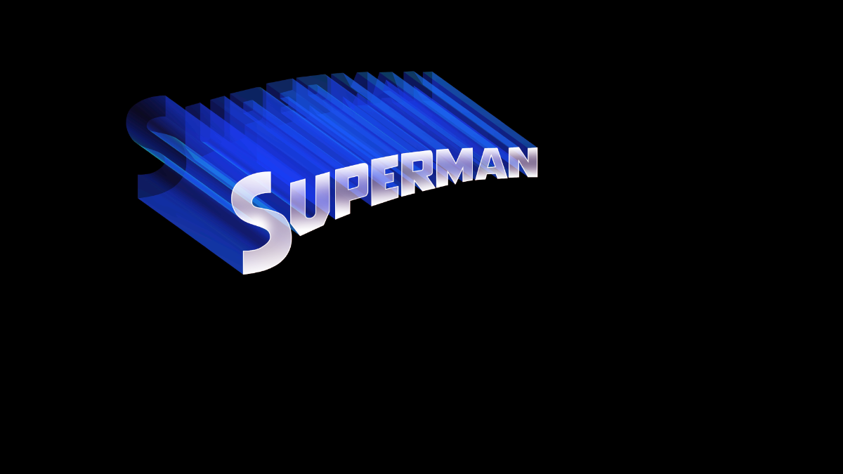

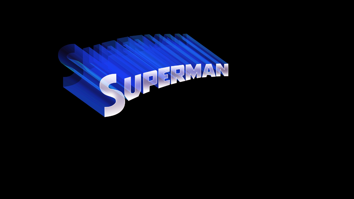

Croweyes1121 Posted June 25, 2021 Author Posted June 25, 2021 (edited) On 6/23/2021 at 10:25 AM, Cad64 said: Yes, it would be helpful to see what you're printing and the different results you're getting. Using different printer drivers can affect the look of the printed output, so try to stick with just one printer driver for consistency. Beyond that, I don't know why you would get different results randomly when printing using the same driver. Is there a reason why you're printing to pdf instead of rendering? You may have to toggle between these two to see what I mean. Notice how the inner portion of the R (the blue streak part) is dimmer in the first image and brighter in second. The top streak on the right portion of the M is brighter in the first, then dimmer in the second. I know this may seem like nitpicking, but I'm doing a frame-by-frame animation, and this jumping around of the lighting looks horrible in motion. I'm keeping the angle from the light sources absolutely consistent, so it's not the position of the letters or streaks that's doing it. Would rendering be a better option? It takes absolutely forever compared to printing to PDF. Edited June 25, 2021 by Croweyes1121 Quote
Cad64 Posted June 26, 2021 Posted June 26, 2021 18 hours ago, Croweyes1121 said: I know this may seem like nitpicking, but I'm doing a frame-by-frame animation, and this jumping around of the lighting looks horrible in motion. I'm keeping the angle from the light sources absolutely consistent, so it's not the position of the letters or streaks that's doing it. Would rendering be a better option? It takes absolutely forever compared to printing to PDF. No, it's not nitpicking. If you're doing an animation then you need your lighting and everything to be consistent. Rendering would certainly provide the consistency that you're looking for, but in all honesty, I would not use Autocad for this. I would use a program that's better suited for this sort of thing. Have you looked at Blender? It's a free 3D modeling/animation program that you could use to render out the full animation to video instead of printing each frame, one at a time and then stitching all the images together. And yes, rendering does take longer because the program is calculating the light bounces off all the surfaces, and that takes some time, but the result is much cleaner and higher quality than printing to pdf. Here's another question. In Autocad, have you set up a camera for viewing the text or are you simply printing a pdf based on your current view in model space or a paper space viewport? I feel like you might have better luck printing from a camera view, but that's just a guess. By the way, how are you printing to pdf with a black background? I've never tried doing this before and I'm not having any luck achieving this. Quote

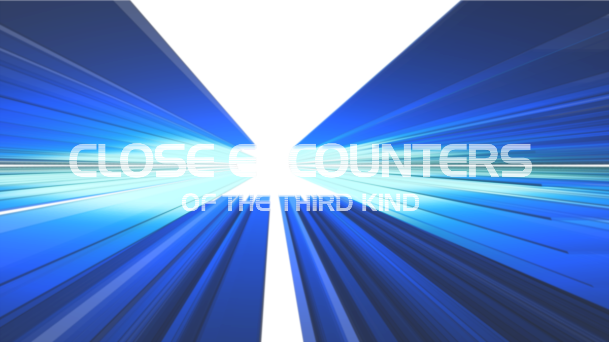

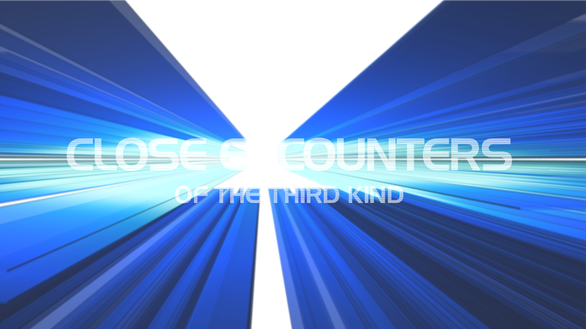

Croweyes1121 Posted August 15, 2021 Author Posted August 15, 2021 (edited) On 8/11/2021 at 9:18 PM, BIGAL said: I have done a few very simple animations the best was walking up a spiral staircase looking at a house in full 3d. Using simple shade not a render image. Have a look at this may be useful link to animation. May not be of use. https://knowledge.autodesk.com/support/autocad/learn-explore/caas/CloudHelp/cloudhelp/2018/ENU/AutoCAD-Core/files/GUID-19E41C48-90E0-4462-9CC3-1BBBECFF5CC1-htm.html Thanks, but no, this will not help. The 3D streaks themselves need to move, not just the camera. Take a look at the examples attached here. All I did was surftrim the 3D streaks along a plane that's parallel with the view. Any time I make any change to the streaks at all, the lighting changes entirely, so it bounces around every frame when I try and show the progression in motion. What I need is for the lighting to be consistent from frame to frame instead of bouncing around at random. I've tried changing the reflectivity of the clear blue glass material (on direct and oblique angles) to matching values - no effect. No matter what I do, the lighting changes every time. Very frustrating. Is there no way to get CONSISTENT lighting? I've tried exporting to PDF and to PNG (the latter alleviates the banding issue that seems to come with PDF export, but the lighting inconsistency problem remains). Edited August 15, 2021 by Croweyes1121 Quote
