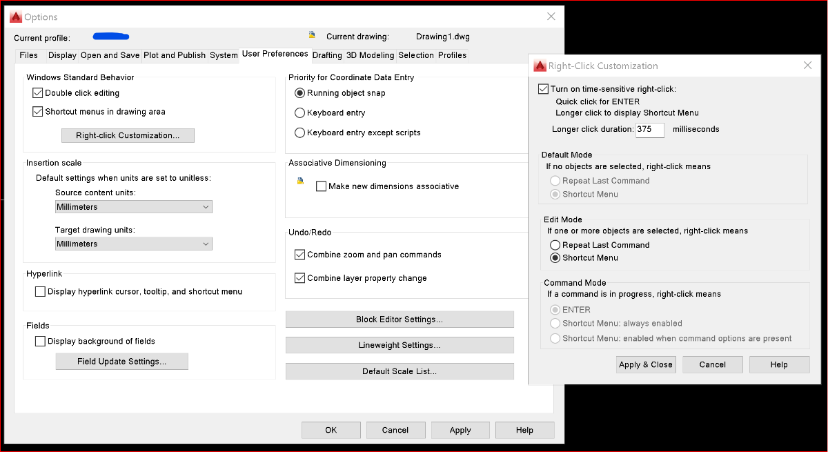

Hi GEO501, welcome to CADTutor.   :)
You sound like a likely candidate for Right-click Customization, which I have always enjoyed.
I hate taking my hand off the mouse.
So this is a bit off topic, but if you are unfamiliar with it, you might enjoy checking it out.
