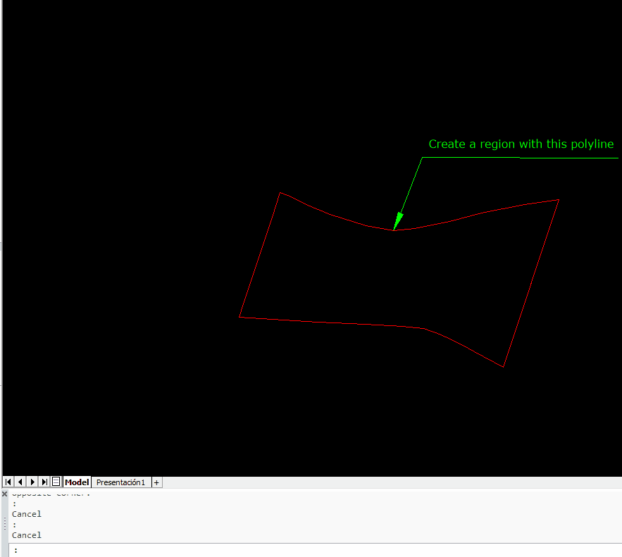

robierzo Posted July 29, 2021 Share Posted July 29, 2021 Hello. Why doesn't this code work to create a region from a polyline? Thanks (setq poly_p (entsel "\nSelecciona una parcela exterior: ")) (setq nombre_ent (car poly_p)) (setq obj_n (vlax-ename->vla-object nombre_ent)) (vlax-invoke (vla-get-modelspace (vla-get-activedocument (vlax-get-acad-object))) 'addregion (list obj_n)) Create a region.dwg Quote Link to comment Share on other sites More sharing options...

mhupp Posted July 29, 2021 Share Posted July 29, 2021 (edited) Still works. maybe what your selecting isn't a poly or closed all the way. I know if you try to region a open poly in BricsCAD it just deletes it Edited July 29, 2021 by mhupp 1 Quote Link to comment Share on other sites More sharing options...
robierzo Posted July 30, 2021 Author Share Posted July 30, 2021 Thanks a lot, mhupp. I do not know what's going on. It doesn't work for me. If I use the code with other polylines, it works. But with this polyline it doesn't work for me. Perhaps it is because this polyline has repeated vertices. Thank you anyway. Quote Link to comment Share on other sites More sharing options...

ronjonp Posted July 30, 2021 Share Posted July 30, 2021 If you use the region command it gives you a clue as to why it won't work: Quote Vertex with degree greater than two : 1 loop. 1 1 Quote Link to comment Share on other sites More sharing options...
robierzo Posted July 31, 2021 Author Share Posted July 31, 2021 (edited) Thanks ronjonp. You are right. I think I should remove the repeated vertices. Does anyone have an app to remove repeated points from a lwpolyline? THANKS!!!! Edited July 31, 2021 by robierzo Quote Link to comment Share on other sites More sharing options...

ronjonp Posted August 3, 2021 Share Posted August 3, 2021 9 hours ago, robierzo said: Hi ronjonp. Vertex number 24 and vertex number 26 are repeated, but it does not eliminate them. Thank you for your trouble. The confutatis routine doesn't work for me. I do not know why. Use overkill .. those polylines are a mess. 1 Quote Link to comment Share on other sites More sharing options...
robierzo Posted August 4, 2021 Author Share Posted August 4, 2021 Hello. In the end I have succeeded. This is what I was looking for. I have included a margin of tolerance so that it eliminates the points that do not fulfill a minimum distance. I have used ronjonp's statement "(vlax-put obj 'coordinates (apply 'append nuevalista_pt))", and I have solved it. Thank you very much to all. (defun c:elptlw () (setq margen_error 0.005) (setq nuevalista_pt nil) (setq ent (car(entsel"\nSelecciona lwpolyline: "))) (setq obj (vlax-ename->vla-object ent)) (setq lista_ent (entget ent)) ;lista_puntos lwpolyline (foreach elemento_n lista_ent (cond ((=(car elemento_n) 10) (if (null (member t (mapcar '(lambda (pt) (< (distance (cdr elemento_n) pt) margen_error)) nuevalista_pt ))) (setq nuevalista_pt (cons (cdr elemento_n) nuevalista_pt)) ) ) ) );fin Foreach (setq nuevalista_pt (reverse nuevalista_pt)) (vlax-put obj 'coordinates (apply 'append nuevalista_pt)) ) Quote Link to comment Share on other sites More sharing options...
