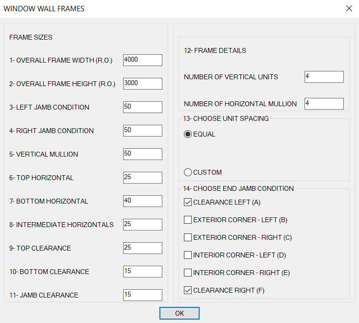

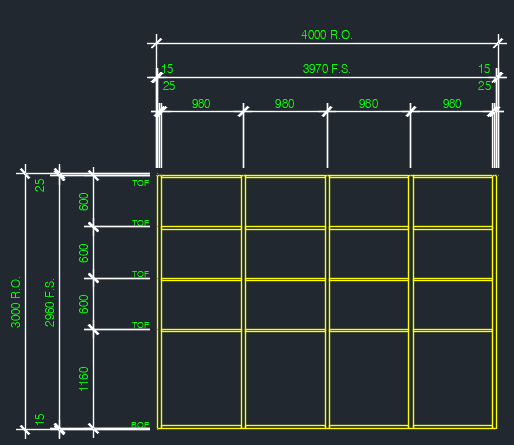

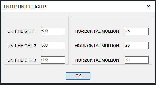

BIGAL Posted August 2, 2021 Share Posted August 2, 2021 (edited) What about this does way more. PM me a email link. I am having problems loading a GIF. The other options are add windows and doors just pick inside a closed area and can auto size your dynamic blocks. This was all created for another Cadtutor poster. Edited August 2, 2021 by BIGAL Quote Link to comment Share on other sites More sharing options...

BIGAL Posted August 13, 2021 Share Posted August 13, 2021 I took a different direction as per image above just pick inside a closed area and the window is auto sized to suit, the visibilty style is chosen from a pop up dcl, left right up down etc. SEnt you a PM as having problems uploading a gif. Quote Link to comment Share on other sites More sharing options...
