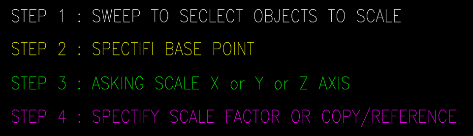

Trai Posted August 3, 2021 Author Share Posted August 3, 2021 7 minutes ago, tombu said: I've never seen anything but references like blocks and xrefs with different properties for x & y scale or seen it done in a lisp. Block could be purged in the lisp after exploding. I've often used this in older versions that would convert polylines into line segments I'd half to rejoin but in current versions polylines return as polylines. Seems like a no-brainer. i want to it as below image Quote Link to comment Share on other sites More sharing options...
tombu Posted August 3, 2021 Share Posted August 3, 2021 3 minutes ago, Trai said: i want to it as below image What happened to the x & y options you asked for? Why not use the Scale command or grip menu? Quote Link to comment Share on other sites More sharing options...
Trai Posted August 3, 2021 Author Share Posted August 3, 2021 1 minute ago, tombu said: What happened to the x & y options you asked for? Why not use the Scale command or grip menu? i want to scale only one direction because in autocad only scale x, y axis together Quote Link to comment Share on other sites More sharing options...

Trai Posted August 4, 2021 Author Share Posted August 4, 2021 this is code for reference: (DEFUN EXCUTE() (setq oldvalue (getvar "CMDECHO")) (setvar "CMDECHO" 0) (princ "select object: ") (setq ss (ssget)) (setq P0 (getpoint "\nSelect base point: ")) (initget 1 "X Y X S") (setq C (getkword "\nSelect axis [X,Y,Z,Scale]?<X/Y/Z/S> :")) (setq hs (getreal "import scale factor: ")) (DELBLOCK "vkc_temp") (CREATEBLOCK ss P0) (Command "-Insert" "vkc_temp" C hs P0 "") (setq dt (entlast)) (Command "Explode" dt) (setvar "CMDECHO" oldvalue) (princ) ) (DEFUN CREATEBLOCK(ss P) (command "-Block" "vkc_temp" P ss "") ) (DEFUN DELBLOCK (bname) (if (IsExistBlock bname) (Command "-Purge" "B" bname "Y" "Y") ) ) (DEFUN IsExistBlock(bname / kq) (setq kq Nil) (setq n (length LiBlk)) (setq i 0) (while (< i n) (if (= bname (nth i LiBlk)) (progn (setq i n) (setq kq T) ) ) (setq i (1+ i)) ) kq ) (DEFUN CREALIBLK (/ NL) (setq LiBlk (List)) (setq NL (tblnext "BLOCK" T)) (while NL (setq LiBlk (append LiBlk (list (cdr (assoc 2 NL))))) (setq NL (tblnext "BLOCK")) ) (setq LiBlk (Acad_strlsort LiBlk)) ) (DEFUN C:XSCALE() (CREALIBLK) (EXCUTE) ) (DEFUN C:SC1() (CREALIBLK) (EXCUTE) ) Everyone can add this feature for me.to replace asking "" import fator scale "" Quote Link to comment Share on other sites More sharing options...
BIGAL Posted August 4, 2021 Share Posted August 4, 2021 A couple of suggestions if making a temp block once exploded then do the purge Block, also (Command "Explode" (entlast)) no need for dt. Quote Link to comment Share on other sites More sharing options...
