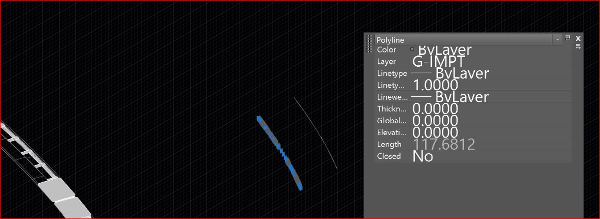

I used the Burst command on the multiple blocks, then used Polyline Edit to Convert to Polylines MULTIPLE.
I then used the PE JOIN option.

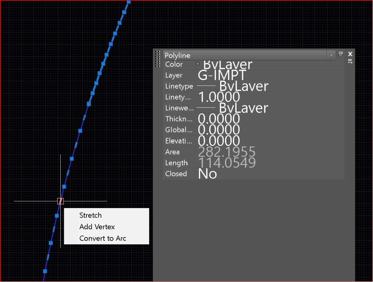

I used my quick properties to set all the Splines to FIT, from Control vertices>
Polyline Edit Multiple selection to JOIN.
Having done that a Midpoint grip appears for each bit with the Convert to Arc option as in the screenshot.
Appreciably less than ideal, presumably there is a much better way to do this, looking forward to
leaarning it when a member of the Splinerratti weighs in.  :huh:

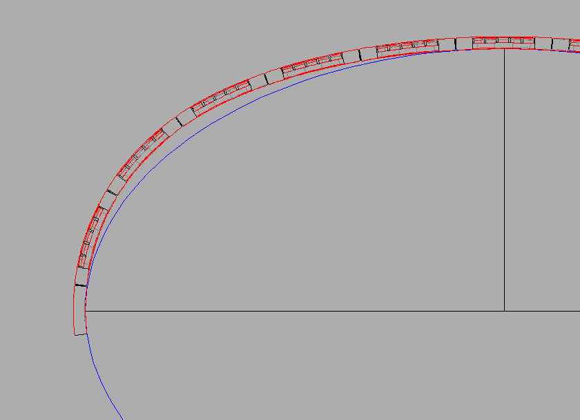

To get a better feel for the shape I created short chords for several of the small mid-span splines (cyan curves) and then perpendicular bisectors (yellow).  If you want to approximated the curve by arcs you could use the intersections of these bisectors as arc center points as you have discussed.  However if you want to approximate the shape with a spline I would take the following approach.
To simplify the task I will assume the shape is symmetric.  The vertical cyan line is an approximate line of symmetry.
Before creating the spline create a horizontal line at the top center vertex as shown below.  The left end of the line will be the right most vertex of the spline and the left end of the line will be referenced to define the spline's tangency.  This will ensure that the curve when mirrored will not have an inflection point at the top and will produce a smooth curve.
Now create a spline using fit points that pass through points (going from left to right) on the spline segments.  After clicking the right most point at the the centerline enter "t" for tangency and click the right end of the horizontal line.  The result should look something like the following (magenta spline).

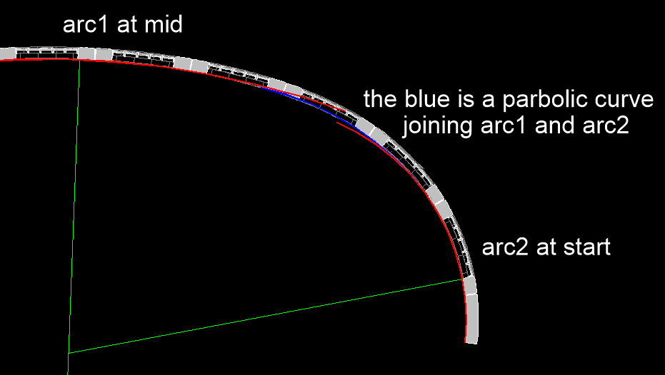

I did look at road vertical curve it takes into account, start point and grade at that point ie tangential, end point again grade at that point, I have  a paper copy of the formula looking for jpg for y=x something then can see if can replicate. But looking at shape maybe this, but note it has a R value which controls the 2 parabola curve answer. I think that is what has been used.
http://onlinepubs.trb.org/Onlinepubs/trr/1994/1445/1445-010.pdf
