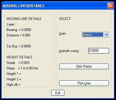

I am trying to get user input for degrees minutes seconds in the format dd.mmss entered into an input box.
I then convert this into decimal degrees which is returned below the input box

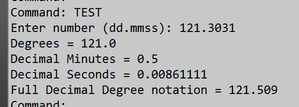

@tombu I'm not sure if your response was to my post but the question I have does not have to do with rtos but to the precision of the the sum of 3 numbers.
The issue Lee Mac discusses in his post on the inconsistencies of rtos addresses the way leading and trailing zeros are handled.   My code uses rtos to convert the format of the way @milesperry 's company wants to be able to specify an angle.   The function rtos does this fine making it possible to handle the characters (digits) preceding the decimal point as degrees, the first two characters after the decimal point as minutes and the 3rd and 4th character after the decimal point as seconds.
Sample result of the program are as follows.  For an input value of 121.3031 (which should be interpreted as 121 degrees, 30 minutes, 31 seconds) the output is as follows:
Why is the output rounded to 3 decimal places if dd = 121.0, mm = 0.5, and sec = 0.00861111 with  (setq decd (+ dd mm sec))?    There's something simple I am missing.

Thankyou lrm

Edited by BIGAL
Thanks @BIGAL We have a dialog box that displays bearings and distances of a survey traverse, with the option to add an Azimuth Swing in a text box and show the corrected bearings with Azimuth applied. This was created by someone that we bought is a small part of an autocad addon that we brought years ago in .vlx format that no longer installs on our latest version. I realize that getreal is better and less problematic but the boss really likes the old version so that's what I'm trying to recreate. We can easily change the units or swing without leaving the dialog box.
The substr seems to work, I just need to add some code to check for numeric string only.
Your right dcl returns a string, even though you appear to type in a real.
