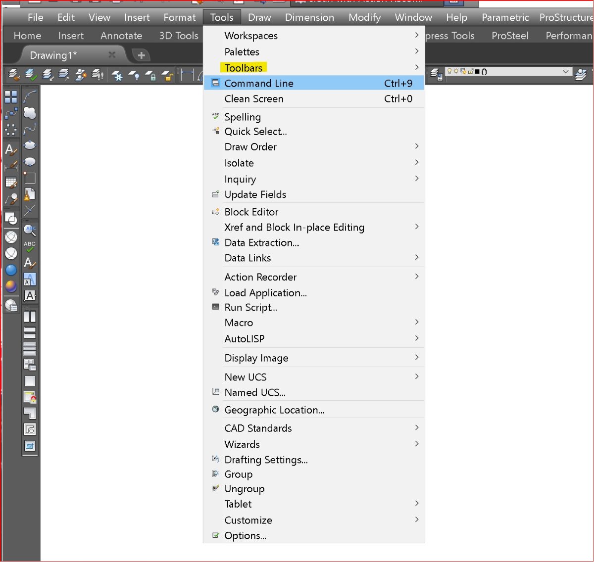

peterg Posted August 24, 2021 Share Posted August 24, 2021 I have been used to using the old style tool menus around the screen, can I get these back in Autocad LT 2022. just dont like the ribbon. if so how? Quote Link to comment Share on other sites More sharing options...
Dadgad Posted August 24, 2021 Share Posted August 24, 2021 I have never used LT, but do still use toobars. Below the Quick Access Toolbar in the top left, if there is a TOOLS option click on it to expand it and select toolbars, probably up pretty close to the top of the list, like in the screenshot? Quote Link to comment Share on other sites More sharing options...
CyberAngel Posted August 24, 2021 Share Posted August 24, 2021 You can get rid of that nasty ribbon by typing RIBBONCLOSE. Then install all the toolbars you need (as Dadgad recommends). Quote Link to comment Share on other sites More sharing options...
rkmcswain Posted August 24, 2021 Share Posted August 24, 2021 4 hours ago, peterg said: I have been used to using the old style tool menus around the screen, can I get these back in Autocad LT 2022. just dont like the ribbon. if so how? Command: RIBBONCLOSE Command: Menubar 1 Quote Link to comment Share on other sites More sharing options...
BIGAL Posted August 25, 2021 Share Posted August 25, 2021 (edited) -toolbar Modify show, once one toolbar is open you can click on it and open others. Right click on the vertical end of the toolbar open more. Edited August 25, 2021 by BIGAL Quote Link to comment Share on other sites More sharing options...
