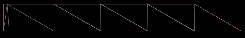

Working on a small project where I have to design an aluminum canopy that has a complex roof. So I think I have to columns and the rafters drawn correctly, so now to put some roof panels on it. I traced what I though would be the outline of the roof surface in one section on the left. I joined the lines to form a 3D Polyline. Then I tried EXTRUDE, CONVTOSURFACE, CONVTEMESH, CONVTOSOLID, but none of these work?
I have the typical panels in the middle working, or appear to be working by using the EXTRUDE command. But the end panels which may or may not need to have other facets in them to close off the roof just will not go for me.

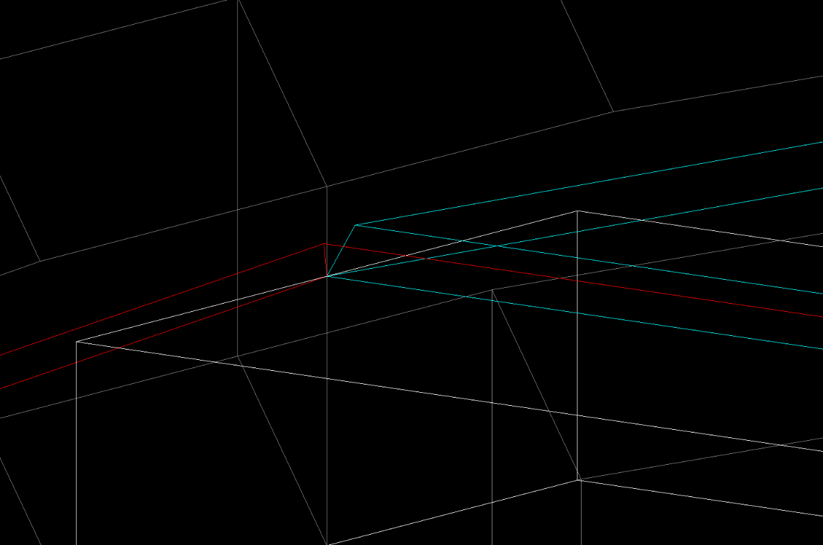

It's not clear what your requirements are and how you want the panels to meet at their edges.  The judicious use of Boolean can be a big help.

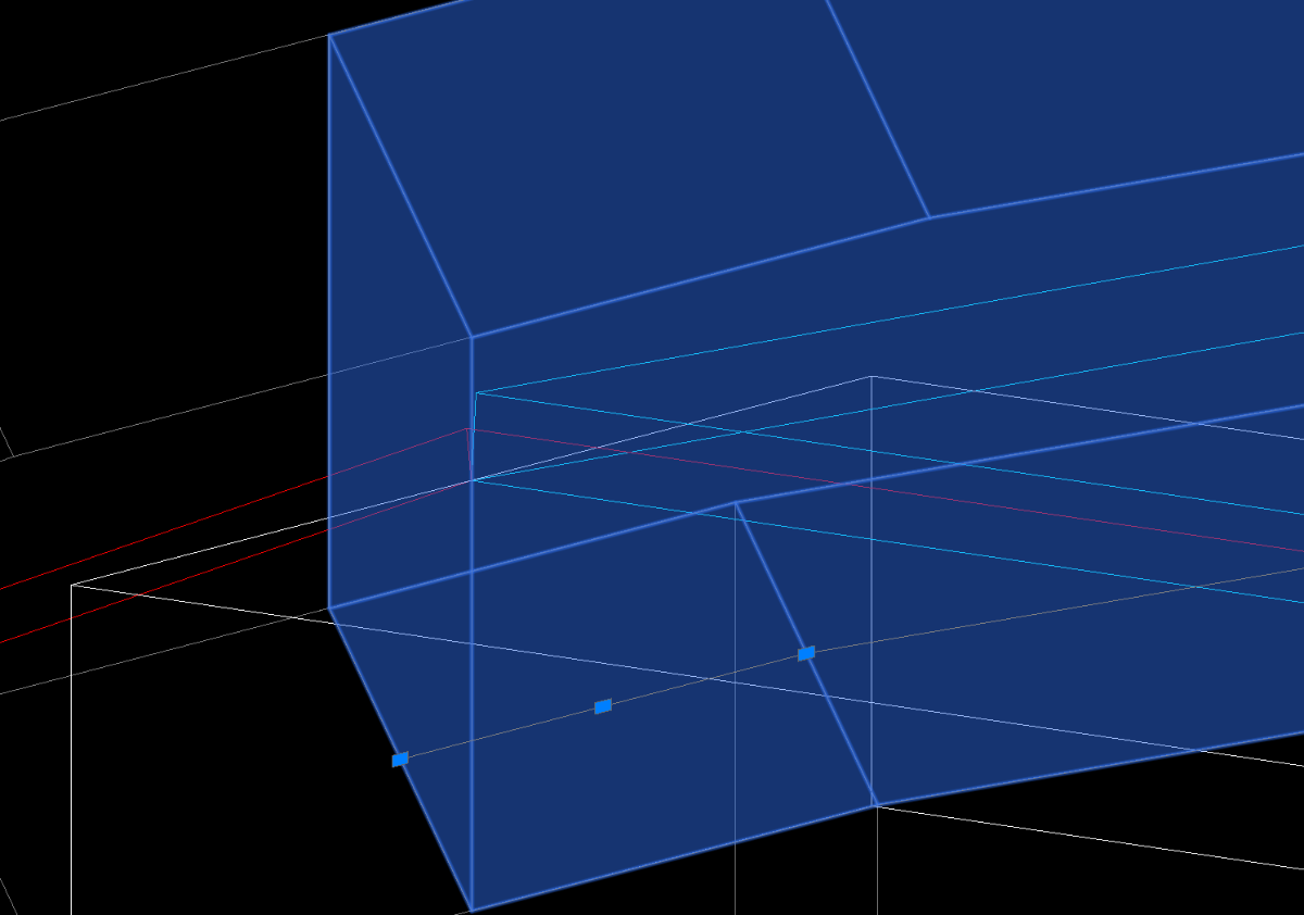

For example, here's a detail of the two right-most panels (I've changed the color of the last panel to cyan for clarity).

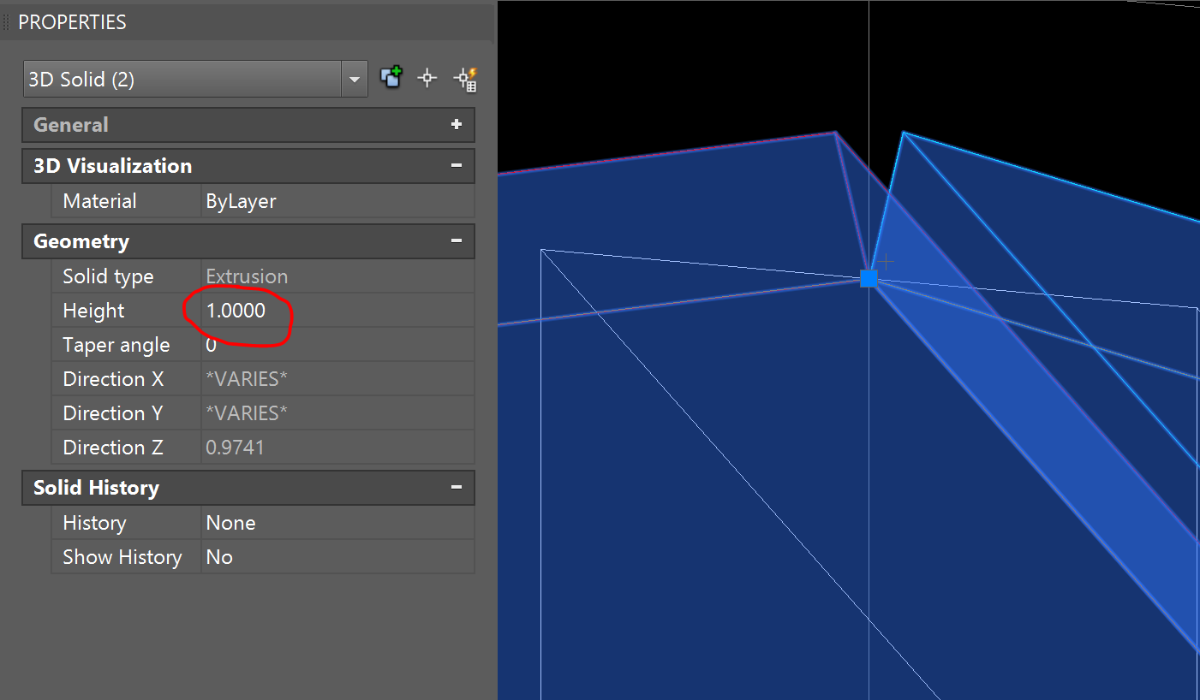

Looking at the properties for both shows that they are both 1" extrusions.

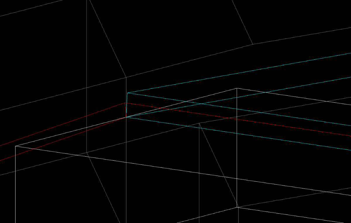

Here's the same area with a visualstyle of 3d wireframe.
The cyan panel may look thicker but that an optical illusion due to the view angle.
Here are the panels viewed from another angle.  Both panels are selected and the height of the two indicate the same value, 1".

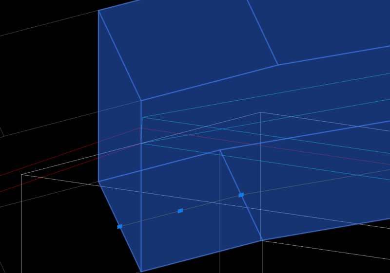

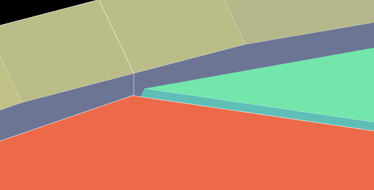

Going back to the previous view I made a copy of the light-gray solid with a displacement of 0,0,0 and then gave the Boolean subtract command.

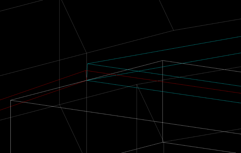

Before the subtract.
After the subtract.
Notice the cyan panel has been trimmed to remove its interference with the frame.
Is you goal to define panels that perfectly mate or have panels with edges that are perpendicular to their faces (i.e., simple extrusions) resulting in gaps between panels and the frame?
