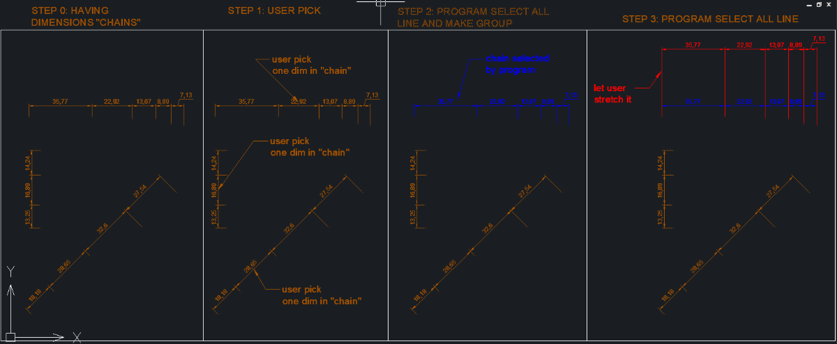

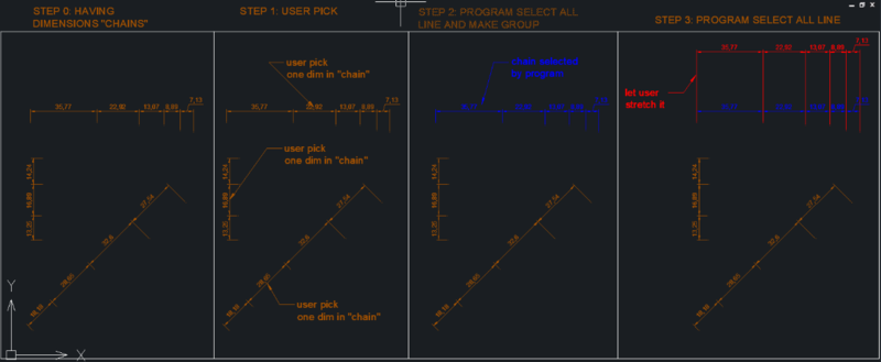

1) select one dimension
2)program is selecting nearly dimensions (colinear, on the same line, continous, I don't know how to name it)
3) program let user to stretch this dimensions.

Nobody hasn't got something even nearly what I need? I will try my best to do it myself, but even don't know how to start. The only idea is that program will catch startpoint/endopint of dimension and catch next if there is dimension in the same point. But I think that there are better options.
Any help, even just the program functions will be helpfull.

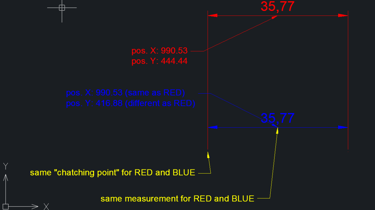

@eldon If I understand You good, it is not what I want. Scale also change measurement. For me it is only require to move line with dims (like dimline offset from catching point). For example for horizontal dims, it will change dims "position Y" of dimline (one more picture to explain)

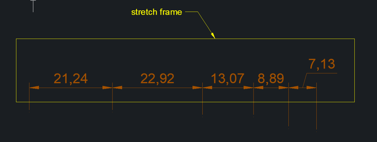

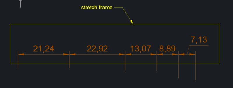

For example for vertical dims it will change "position Y". So it should work like stretch command with the frame like here for horizontal:
dimchainage.dwg
Edited by zwonko

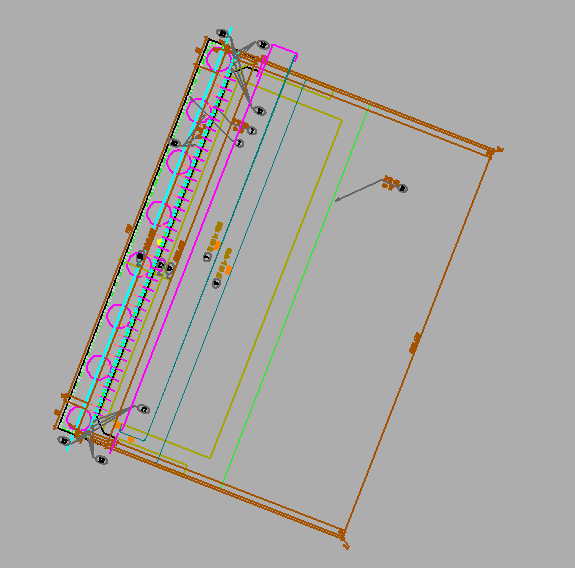

It works. But this is only the sample DWG , very simple DWG. But if having something like in attachment there is a problem with selecting dim line because there is plenty of other object to remove from frame.  Probably LAYISO and LAYUNISO will be helpfull for selecting, but, there are still dimension lines where are very close to each other and user must be carefull for selecting streatching frame or must unselect unwanted elements.
real2.dwg
I found Stretch worked very well.
I locked all layers and then unlocked the dimension layer. Then I used Stretch with the crossing-polygon selection window. I had to de-select a few objects, but really no problem even with the rotated section.
