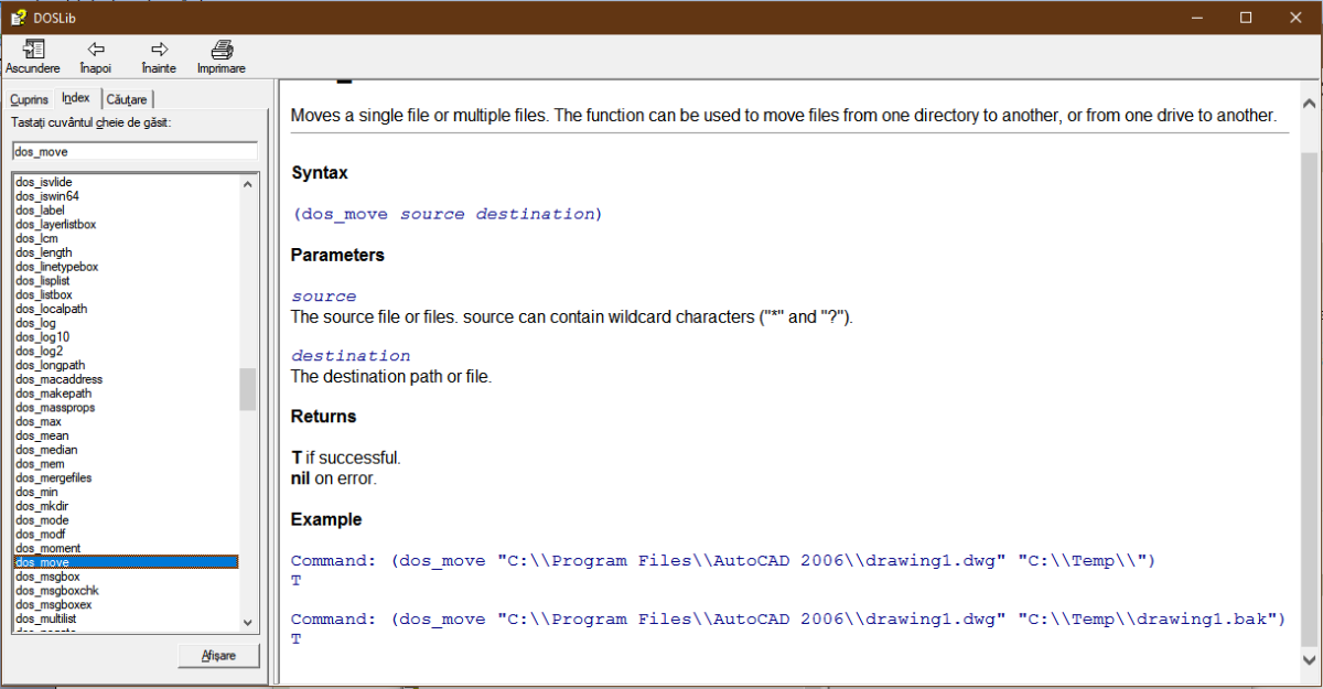

lido Posted September 13, 2021 Share Posted September 13, 2021 You may use dos_move function from DOSlib. Quote Link to comment Share on other sites More sharing options...
hosyn Posted September 14, 2021 Author Share Posted September 14, 2021 thank you so much lido for new Quote Link to comment Share on other sites More sharing options...
