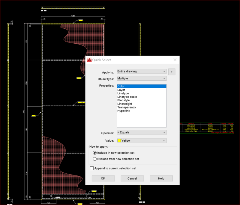

Dadgad Posted September 22, 2021 Share Posted September 22, 2021 (edited) Quick Select maybe? Edited September 22, 2021 by Dadgad Screenshot added Quote Link to comment Share on other sites More sharing options...
