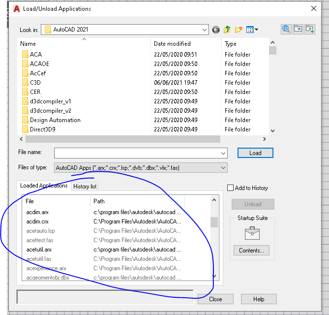

AlanCapuano Posted October 14, 2021 Posted October 14, 2021 Hi all Is there a way to achieve the above by coding, ie, retrieve a text list of all loaded application in AutoCAD with path, as the one you see in APPLOAD command? Thanks for your time Alan Quote
Steven P Posted October 14, 2021 Posted October 14, 2021 I haven't seen a way yet to search what is loaded and return the file path of each. Someone else might know. If these are all in your 'trusted locations' folder you might be able to get that. Not every loaded application will be there though. for everyone. if you know the file path this will give you a list of files in that location (with *.lsp file type), you should be able to find something online to copy a list to a text file (setq lispfiles (vl-directory-files lispfilefolder "*.lsp" nil)) ;;list of files in lispfilefolder location - include full file path and double \ as required Quote
AlanCapuano Posted October 14, 2021 Author Posted October 14, 2021 Thanks Steven The problem is that I'll not know in advance where the lisp will be located, and in my case it won't be in a trusted folder. Quote

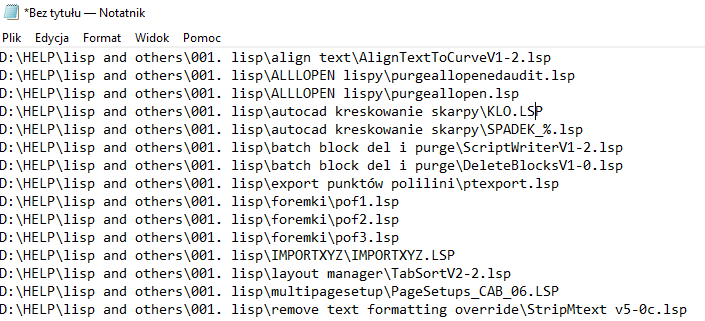

zwonko Posted October 14, 2021 Posted October 14, 2021 (edited) file in zwcad 2021 is in: C:\Users\YOURUSER\AppData\Roaming\ZWSOFT\ZWCAD\2021\en-US\ it's name is: appload.dfs sample on screenshot: But checked on ACAD2014 and there is not such file. Also tried to search like i did found it on ZWCAD, usig windows search, but it found nothing. Maybe ACAD stores it in registry. Googled about file "appload.dfs" and there is not many info about. Just try to search some of Your lisp in regedit Edited October 14, 2021 by zwonko Quote
AlanCapuano Posted October 14, 2021 Author Posted October 14, 2021 Great tip about the registry. I have tried it but still no joy - it's not stored in there apparently. Quote

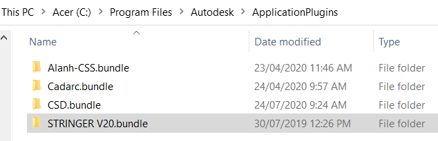

BIGAL Posted October 16, 2021 Posted October 16, 2021 My $0.05 if you use a Bundle approach its all done for you, it sets the paths, loads the menu's a simple unzip to a directory. You just need a sample bundle and edit the xml file to suit. The cadarc.bundle has around 130 items, lisp, slides, dwgs and menu's. Quote
