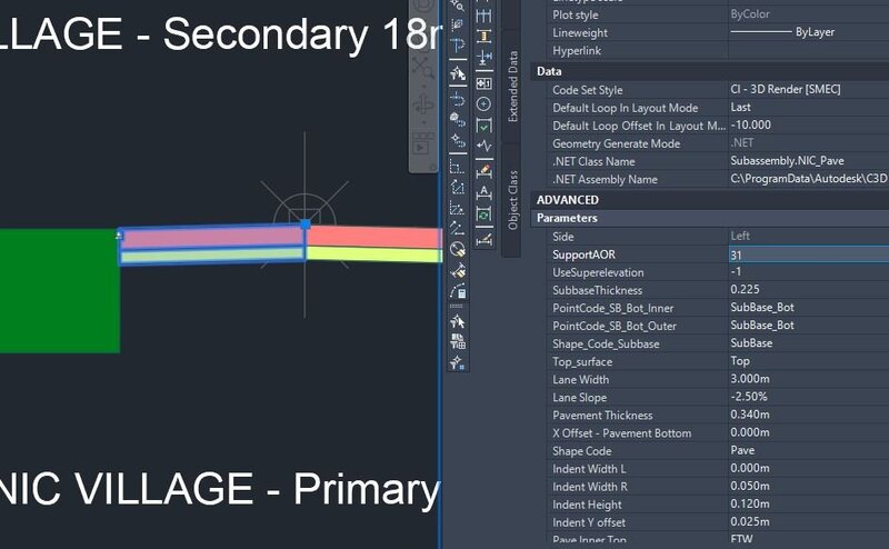

bsimpson Posted October 18, 2021 Share Posted October 18, 2021 Hi when I add the parameter superelvation to a subassmebly the properties do not change correctly when viewed in Civils3d. They show SupporAOR = 31 and UseSuperelevation = -1 when they should show SupportAOR as supported or unsupported. and UseSuperelvation as Left lane or right lane e.t.c Quote Link to comment Share on other sites More sharing options...
