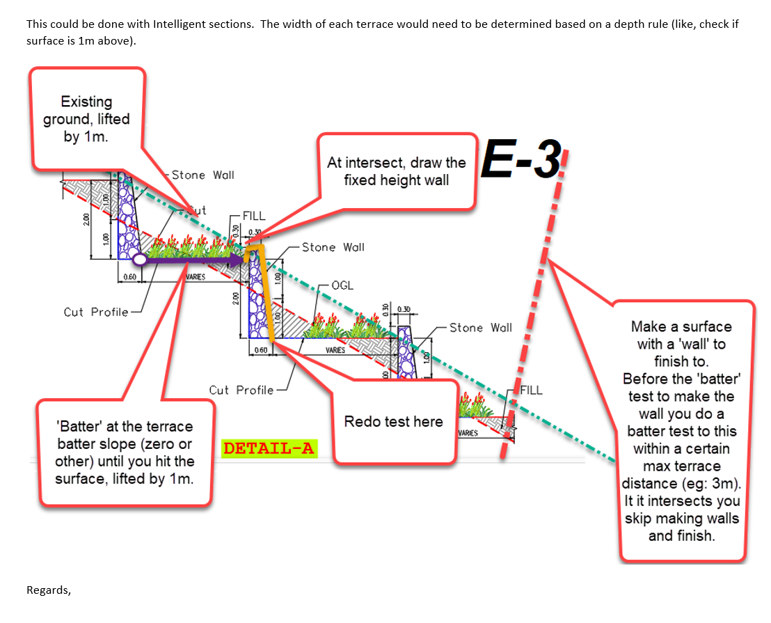

afrazahmed Posted October 25, 2021 Author Share Posted October 25, 2021 4 hours ago, BIGAL said: Here is what I use https://civilsitedesign.com/ How to use Delight feature like in civil 3d for cut fill bench/berms produced Quote Link to comment Share on other sites More sharing options...
BIGAL Posted October 26, 2021 Share Posted October 26, 2021 I asked the guys at Civil Survey Solutions what they thought about this and got this reply. You can contact them directly at Civilsurveysolutions.com.au may be feasible. normally would be only 1 or 2 batters. Quote Link to comment Share on other sites More sharing options...

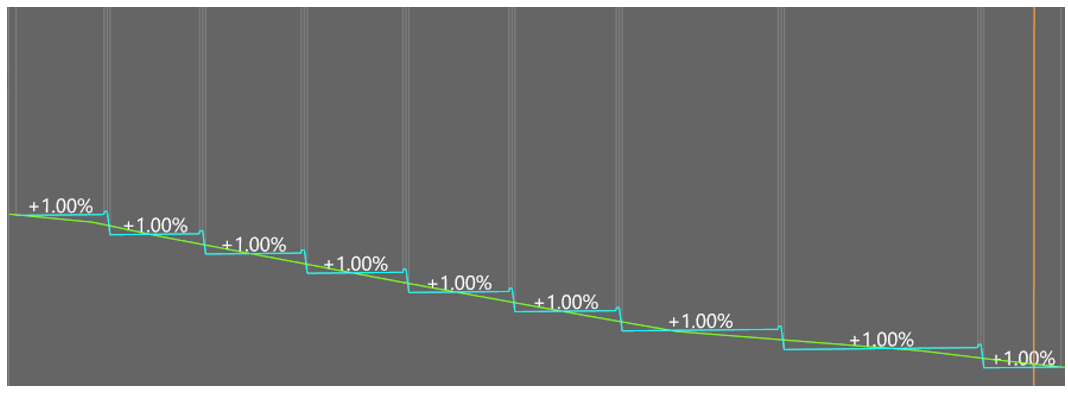

BIGAL Posted October 26, 2021 Share Posted October 26, 2021 This is direct from software. Quote Link to comment Share on other sites More sharing options...
afrazahmed Posted October 26, 2021 Author Share Posted October 26, 2021 1 minute ago, BIGAL said: This is direct from software. from which software this is? Quote Link to comment Share on other sites More sharing options...
BIGAL Posted October 27, 2021 Share Posted October 27, 2021 (edited) Civil Site Design which I posted the link earlier, Home - Civil Site Design Did you download a trial ? Its in the Road option. Edited October 27, 2021 by BIGAL Quote Link to comment Share on other sites More sharing options...
