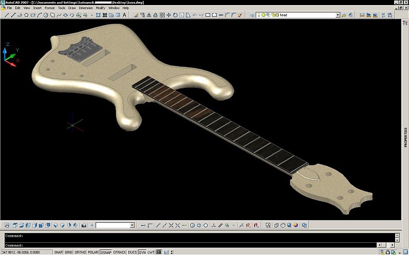

funkyman Posted November 19, 2008 Share Posted November 19, 2008 I used the fillet command to make a radius around the bass body Quote Link to comment Share on other sites More sharing options...

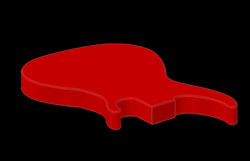

jongor Posted June 9, 2009 Share Posted June 9, 2009 Reviving an old thread....I'm trying to do a guitar body too, but can't seen to get the Fillet command to work with the Chain option. How did you build your 3-d solid for the body before trying to fillet it? I drew the outline and extruded it. bass-body3.dwg Quote Link to comment Share on other sites More sharing options...
shift1313 Posted June 9, 2009 Share Posted June 9, 2009 the issue with your drawing is the way you created it. where is the start/end of your spline? Your solid will fillet if you enter a value of .125 or smaller for your radius. There is no need to Chain because you edge is 1 continous spline. The issue i think is where ever your start/end point is. Your best bet is to create your object with pline using lines/arc and fillet your corners to get the shape you want. Quote Link to comment Share on other sites More sharing options...
jongor Posted June 9, 2009 Share Posted June 9, 2009 Don't know....why would that matter? See attachment, that's how it should look, although it's not a continuous pline. bass-body3.dwg Quote Link to comment Share on other sites More sharing options...

funkyman Posted June 10, 2009 Share Posted June 10, 2009 1.I,ve drawed the splines of the body and join them to get closed object. 2.use the region command to create planar object. 3.extrude created region & specify the height of extrusion (in our case It's the thickness of guitar body) 4.use fillet command to create fillet around Quote Link to comment Share on other sites More sharing options...
jongor Posted June 10, 2009 Share Posted June 10, 2009 Tried this, same result, no fillet. When extruding a close object (like a region or polyline) there's no side to fillet to.... See attached dwg. 1.I,ve drawed the splines of the body and join them to get closed object.2.use the region command to create planar object. 3.extrude created region & specify the height of extrusion (in our case It's the thickness of guitar body) 4.use fillet command to create fillet around bass-body3.dwg Quote Link to comment Share on other sites More sharing options...

funkyman Posted June 10, 2009 Share Posted June 10, 2009 The way how to do it is the same as I described above but I used the fillet 0.1 mm Quote Link to comment Share on other sites More sharing options...
jongor Posted June 10, 2009 Share Posted June 10, 2009 I really don't want to post my email in an open forum like this...isn't there some way to send emails between members? Quote Link to comment Share on other sites More sharing options...
funkyman Posted June 10, 2009 Share Posted June 10, 2009 As shift 1313 said "Your solid will fillet if you enter a value of .125 or smaller for your radius" Quote Link to comment Share on other sites More sharing options...
