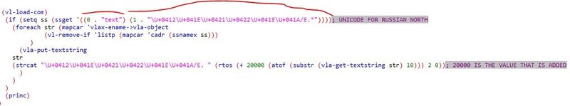

I am using the attached lisp to increment predefined value to East (attributes) Co-ordinates (Russian text and English text). after running this program I am getting the following error------ error: Automation Error. Calling method AddItems of interface IAcadSelectionSet failed also the lisp not working properly.
also I need to increment predefined amount in East Co-ordinates, but it is not working properly.
Can any one please help me come up with an automated method by attaching Lisp to edit text string with a constant number? Since I have drawings with a lot of coordinates needed to be changed and with the lisp.
Test.dwg Increment_All_cords_.lsp

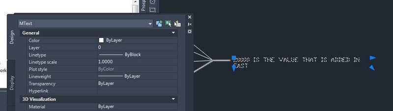

Hi
I don't understand what you want
If you explain in a video
Your text is mtext
The Lisp asks for a text
(defun c:RUSSCORD (/ ss str)
 (vl-load-com)
  (if (setq ss (ssget '((0 . "text") (1 . "\U+0412\U+041E\U+0421\U+0422\U+041E\U+041A/E.*")))); UNICODE FOR RUSSIAN NORTH
    (foreach str (mapcar 'vlax-ename->vla-object
             (vl-remove-if 'listp (mapcar 'cadr (ssnamex ss)))
      (vla-put-textstring
    str
    (strcat "\U+0412\U+041E\U+0421\U+0422\U+041E\U+041A/E. " (rtos (+ 20000 (atof (substr (vla-get-textstring str) 10))) 2 0)); 20000 IS THE VALUE THAT IS ADDED

3 hours ago, Emmanuel Delay said:
Also notice: the third block from the top has the East coordinate in the wrong attribute
Yes...Sorry for that...
I can't help you with the coordinates who are in a wrong attribute.
For the rest, this works.
Command INE.
This code assumes the coordinates are always integers.  Are they?

Thank you so much.... i will try this

Thank you so much....its works
