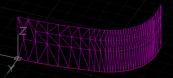

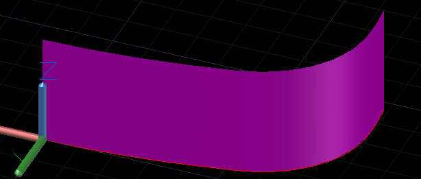

Here's your spline extruded by 200 in the Realistic visual style.  It looks pretty smooth to me. Facetres = 0.5 for this image.
Note that the tessellation used to display the surface looks like this with facetres = 0.5

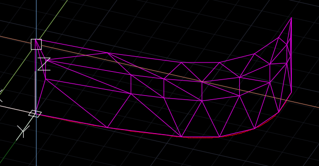

Changing facetres = 0.1 yields:

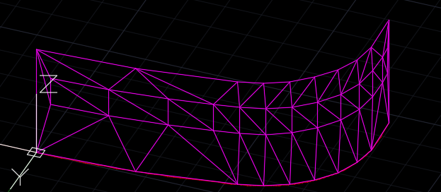

While a value of 5 yields:
So your problem may be due to a small value for facet res.

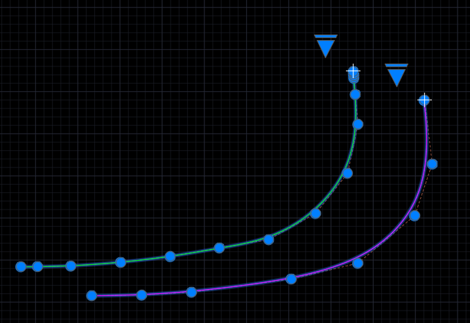

It is worth examining the CVs used to define the spline.  In the image below the green curve is your original spline with 15 CVs while the magenta one is a copy of the spline with several CVs deleted by using splinedit resulting in just 8 CVs.  Some of the remaining CVs have been move to best approximate the original curve but without the undesired undulations.
Keep in mind that the second and next to the last CV control both the slope and the radius of curvature at the ends of the spline. With this in mind excessive CVs near the spline ends can be deleted.   I deleted a couple of the mid-span CVs as they appeared to be influencing a reversal of curvature.
