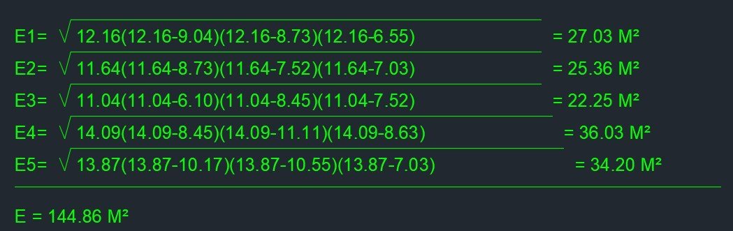

Guest Posted December 7, 2021 Posted December 7, 2021 (edited) Hi .I am using Heron formula to calculate the area of close polylines. I am searchin for a lisp code to select the polyline and draw the triagles like the attach image Thanks Edited December 7, 2021 by prodromosm Quote

Guest Posted December 15, 2021 Posted December 15, 2021 (edited) Hi GP .Gauss is analytic but i don't want calculate area with point coordinates. It must be done with Heron formula. I use this code for Heron formula. Thats way i want a lisp to cut triangles and then 1) select all triangle and inset text (E1,E2,..............) like the code below 2) I want to convert this code to inser a text or mtext like the image bilow Thanks (defun c:heron (/ tri-no p1 p2 p3 da db dc s E cp lst cnt fn fp Etotal) (vl-load-com) (setvar "OSMODE" 9) (command "_layer" "_m" "Τύπος του Ήρωνα" "_c" "7" "" "") (defun tricent (pt1 pt2 pt3)(mapcar '(lambda (x y z) (/ (+ x y z) 3)) pt1 pt2 pt3)) (setq tri-no 0 Etotal 0) (while (and (setq p1 (getpoint "\nP1 : "))(setq p2 (getpoint "\nP2 : "))(setq p3 (getpoint "\nP3 : ")) (setq da (distance p2 p3)) (setq db (distance p3 p1)) (setq dc (distance p1 p2)) (setq s (/ (+ da db dc) 2.0) ) (setq E (sqrt (* s (- s da) (- s db) (- s dc))))) ; while valid points are given (if (assoc (setq cp (tricent p1 p2 p3)) lst) (prompt "\nPoint allready entered") (progn (setq lst (append lst (list (cons cp (list (setq tri-no (1+ tri-no)) s da db dc E ))))) (entmakex (list '(0 . "TEXT") (cons 10 cp) (cons 40 0.5) (cons 1 (strcat "E" (itoa tri-no))))) ) ) ) (if (and (vl-consp lst) (setq fn (vl-filename-mktemp ".txt"))(setq fp (open fn "w"))) (progn (foreach x lst (setq x (cdr x) tri-no (nth 0 x) s (nth 1 x) da (nth 2 x) db (nth 3 x) dc (nth 4 x) E (last x)) (write-line (strcat "E" (vl-princ-to-string tri-no) " = " "\U+221A" " " (vl-princ-to-string (rtos s 2 2 )) " x (" (vl-princ-to-string (rtos s 2 2)) " - " (vl-princ-to-string (rtos da 2 2 )) ") x (" (vl-princ-to-string (rtos s 2 2)) " - " (vl-princ-to-string (rtos db 2 2 )) ") x (" (vl-princ-to-string (rtos s 2 2)) " - " (vl-princ-to-string (rtos dc 2 2 )) ") = " (rtos E 2 2) " m2" ) fp) (setq Etotal (+ Etotal E)) ) (write-line (strcat "E = " (vl-princ-to-string (rtos Etotal 2 2)) " m2") fp) (close fp) ) ) (startapp "notepad" fn) (setvar "OSMODE" 9) (princ) );close defun Edited December 15, 2021 by prodromosm Quote
