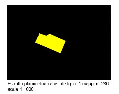

I inserted a .jpg file when I launch print preview or when I print in pdf the image becomes completely blac
Giovannino60

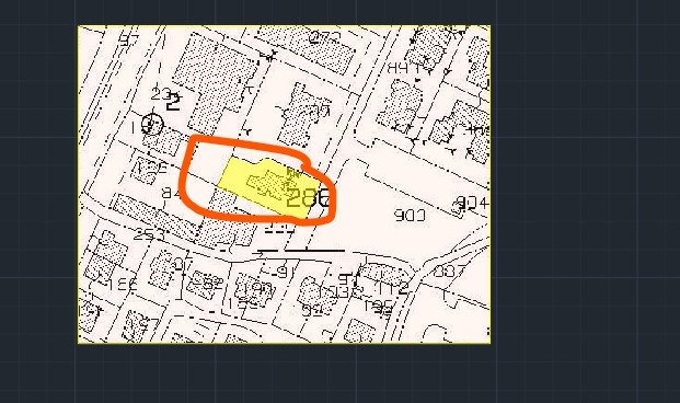

1) I inserted a .jpg file
2) then I placed a screen above
3) when I launch print preview or when I print in pdf the image becomes completely black.
4) Only the yellow screen remains visible.
What can I do?
Thanks
How did you do this 2) then I placed a screen above sounds like a wipeout.
I have done 3 levels over a jpeg, base image, a wipeout then a new jpg or in my case linework. The wipeout must match the outline shape of the top object.
