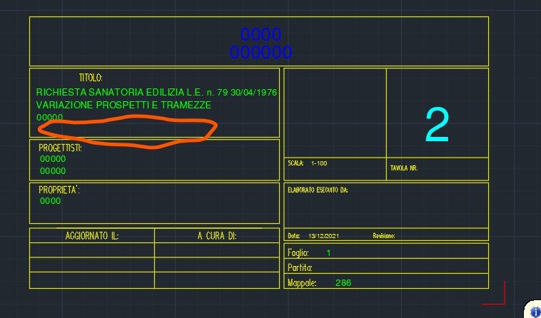

Giovannino60 Posted December 10, 2021 Share Posted December 10, 2021 In this block, how should I proceed to add a row? Thank you Disegno1.dwg Quote Link to comment Share on other sites More sharing options...
BIGAL Posted December 11, 2021 Share Posted December 11, 2021 Admin double post. You can use BEDIT to edit the block and add a line. Quote Link to comment Share on other sites More sharing options...

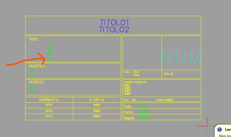

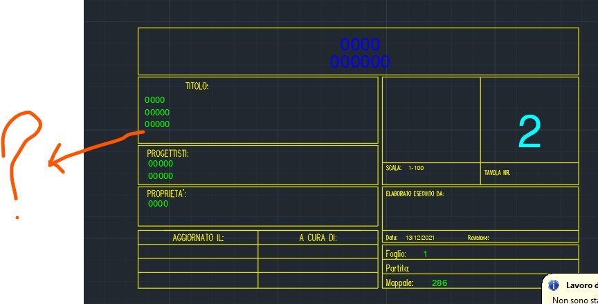

Giovannino60 Posted December 11, 2021 Author Share Posted December 11, 2021 (edited) In the block I see the fourth row, but instead in the table I can not write the row is not there, what can I do? thank you Edited December 11, 2021 by Giovannino60 Quote Link to comment Share on other sites More sharing options...
SLW210 Posted December 13, 2021 Share Posted December 13, 2021 You may need to use ATTSYNC. ATTSYNC (Command) | AutoCAD 2020 | Autodesk Knowledge Network You should look into Block Attributes. Quote Link to comment Share on other sites More sharing options...
