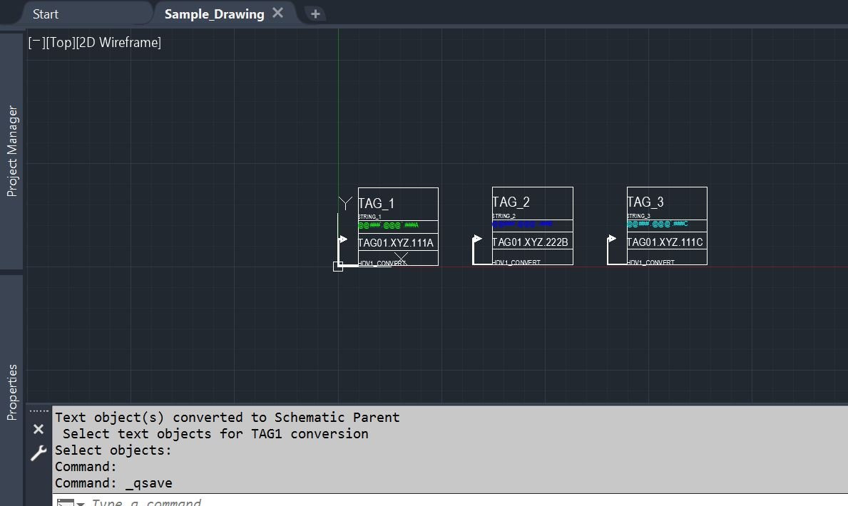

1: Searches the text according to the wildcard setting
2: selects all texts found
3: If the wildcard is found, it creates the layer and changes the blocks to its layers.
4: Sets the color of the layer
5: converts to block (HDV1_CONVERT)

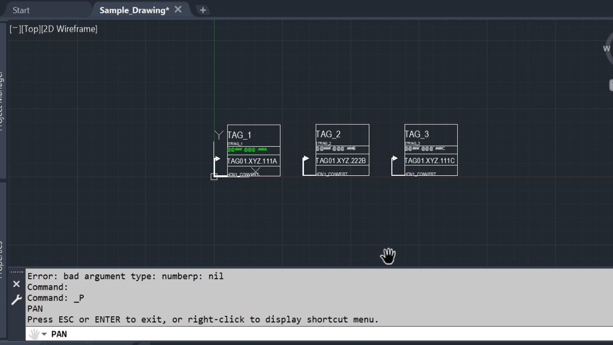

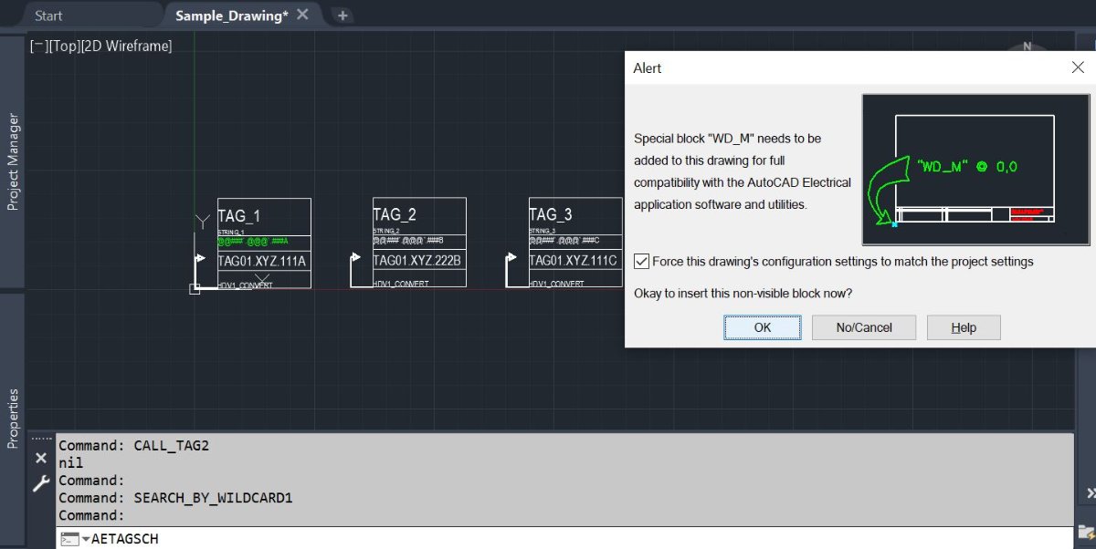

As you can see in the attachment, when I run the script for the first time, the alert appears.
Is there any way to accept the alert automatically?
