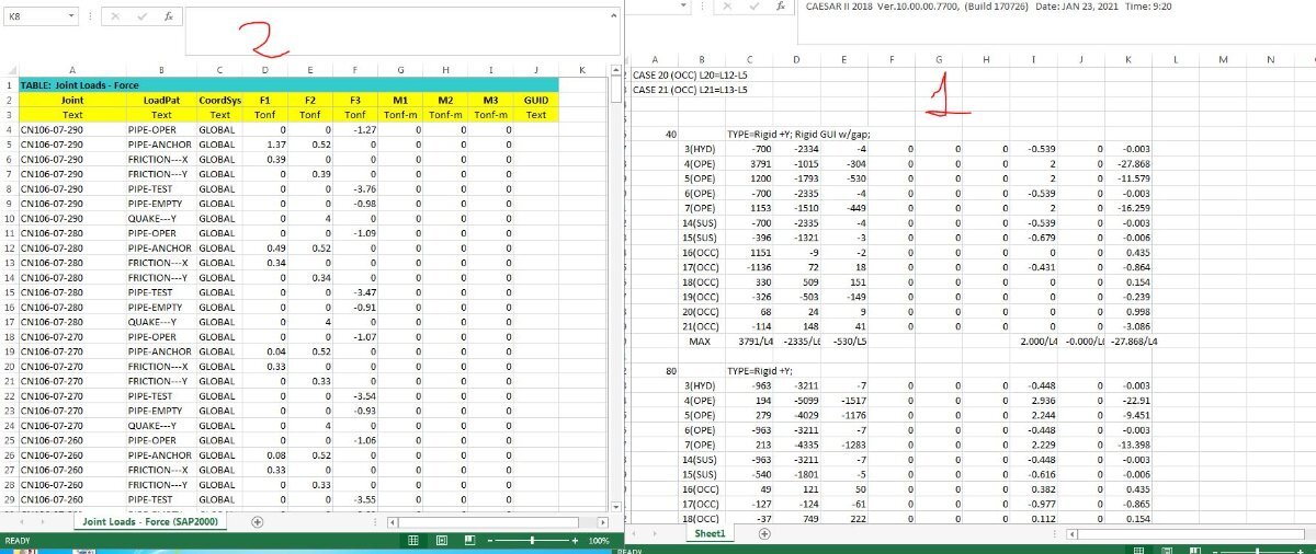

I have a folder in specific direction and it contains .xls or .xlsx files for example the folder include 20 .xls or .xlsx files.
I would be grateful if you help me how to create a LISP to covert all these files to .csv files.
I know .csv file only have on sheet and it is no problem for what i want to do so it will be no problem for me if the other sheets will be deleted.
Best regards

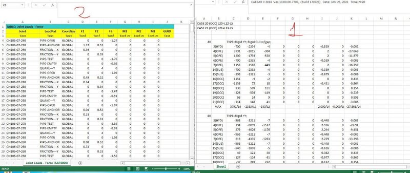

and this is a result file in attachment but I did a process to create this file actually ma main problem is the user should convert all .xls or .xlsx file to .csv and as i have 100 of them it maybe take some time.

Hi
I couldn't understand how to connect the first picture with the result in the second picture
There is no connection between them, did you explain that?
And if you want to draw it in AutoCAD
There is no need to convert, take the data directly from Excel
If your ultimate goal becomes clear, it will be better
From the second file, these look like results from SAP2000
And you want to turn it into a drawing, I think

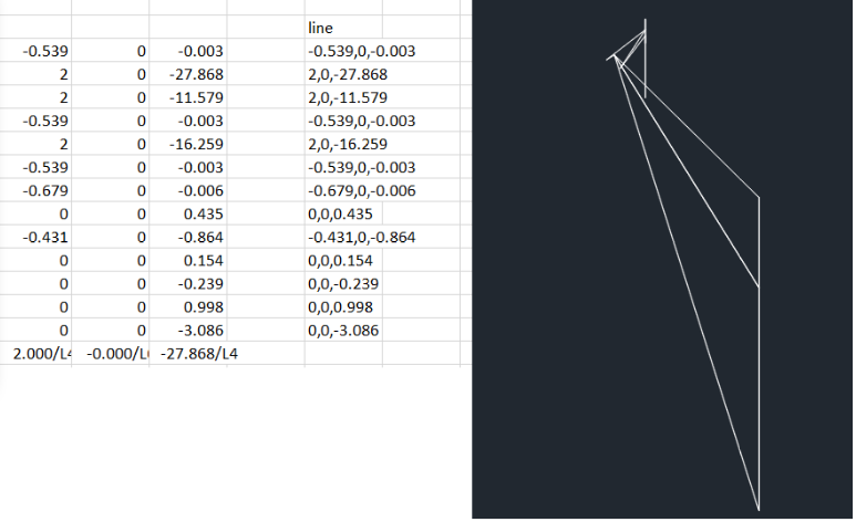

Like hosneyalaa I am confused what it is your trying to do, as a Civil engineer have played with points and stringing for years, a PXYZD file is very common.
Post a xls and a  csv that match, need then a dwg to see what joins to what. Only need a few lines etc.
Is this what you want ?
