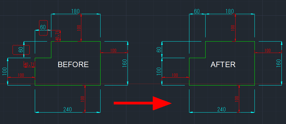

Help me create a lisp to change the distance from the dimension line to the object.
or is there a way to set the default distance from the dimension line to the object for each dimstyle ?

Try this.
Certainly not completely as it should be, but it's a start.
So ... DXF 13 and 14 are the points to be measured.
I measure the midppoint between those points, then DXF 10 and 11 are set 30 units (the user sets this) from that midpoint, perpendicular to the line 13 - 14.
So for the moment it's for aligned dimentions, it won't work in all conditions.
Command DFD

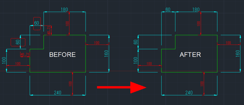

@Emmanuel Delay your code places the dimension on the opposite side of the line when ar is to the left of al and the aligned dimension goes from left to right.
Here's a before and after shot.
I avoid using angles although sometimes it is easier.  Here's a modified version of your code using vectors.

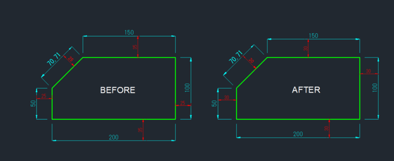

@lrm, thanks, your code worked great. But in case of sizes with different length extension lines doesn't work. Can you help me?
test2.dwg
Edited by TINDANG
I did the lisp as the  the image post.
I have as My personal rule , to work on the ORIGINAL image or sample.dwg , and never make any GUESS, neither ask to an ORACLE what the OP what he could done or will do .
arrange dim texts.dwg

It looks like you did guess about the direction of the line segment and the sequence of the dimensioned vertices.  E.g.,  reverse the direction  of the polyline in your test drawing "arrange dim tests.dwg".  It is best to to minimize guesses about an OP's post but I have found many are in need of some interpretation.
@devitg  It looks like we both assumed that the dimensions were aligned.  Do you have a clean way to determine if a dimension line is linear vs. aligned?
@Irm , at this case I broke my own rule , a made a dwg from trash.

(defun deg2rad (ang / )
  (/ (* PI ang) 180.0)
(defun rad2deg ( ang / )
  (/ (* 180.0 ang) PI)
;; midpoint of 2 given points
(defun mid ( pt1 pt2 / )
  (mapcar '(lambda (x y) (+ (* 0.5 x) (* 0.5 y)))
  pt1
  pt2
;;;  Calculate unit vector of vector a
(defun uvec
  (a / d)
  (setq	d (distance '(0 0 0) a)
	a (mapcar '/ a (list d d d))
; Compute the dot product of 2 vectors a and b
(defun dot ( a b / dd)
  (setq dd (mapcar '* a b))
  (setq dd (+ (nth 0 dd) (nth 1 dd) (nth 2 dd)))
)					;end of dot
  (princ "\nDistance DIM: ")
  (setq dist (getreal))
  (princ "\nSelect DIM: ")                                    ;edited line
(setq exss (ssget '((0 . "*dim*"))))                           ;edited line
(setq exssl (sslength exss))                                   ;edited line
(setq exssindex 0)                                             ;edited line
(repeat exssl                                                    ;edited line
 (setq exssent (entget (ssname exss exssindex)))         ;edited line
;(while (setq sel (entsel "\nSelect DIM: "))                ;edited line
;	  (setq ent (car sel ))                               ;edited line
 (setq ent (cdr (car exssent)))                                 ;edited line
 (setq txp (cdr (assoc 10 (entget ent))))
 (setq al (cdr (assoc 13 (entget ent))))
 (setq ar (cdr (assoc 14 (entget ent))))
;;;	  (setq ang1 (angle al ar))
;;;	  (setq mp (mid al ar))
;;;	  (setq ang2 (angle mp txp))
;;;	  (if (< ang1 ang2)
;;;		(setq tp (polar mp (+ ang1 (deg2rad 90.0)) dist))
;;;		(setq tp (polar mp (- ang1 (deg2rad 90.0)) dist))
 (setq mp (mapcar '/
             (mapcar '+ al ar)
	 '(2. 2. 2.)
; uALR = unit vector from al to ar
(setq uALR (uvec (mapcar '- ar al)))
(setq s (dot uALR (mapcar '- txp al)))
; txpp = projection of txp onto the line
(setq txpp
       (mapcar '+ al (mapcar '* uALR (list s s s)))
(setq uvt (uvec (mapcar '- txp txpp)))
(setq tp (mapcar '+ mp (mapcar '* uvt (list dist dist dist))))
(entmod
  (subst (cons 10 tp) (assoc 10 (entget ent)) (entget ent))
(entmod
  (subst (cons 11 tp) (assoc 11 (entget ent)) (entget ent))
;)                                           ;edited line while delted
 (setq exssindex (+ exssindex 1))    ;edited line for repeat added
