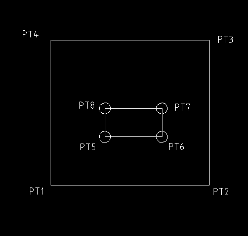

During shut downs we get requests for many wear plates very quickly. These are generally a rectangle with 2 to 4 holes.
What I am hoping for is a way to do something like the following just by entering the x and y coordinates:
rec (manual select point) -X,Y rec @X1,-Y1 X2,-Y2, circle on 4 corners of the last rectangle, delete the last rectangle, then repeat.
I don't know if all of this can be done but as much as possible would be great.
SAMPLE WEAR PLATE DRAWING.dwg

Is the inner rectang required or is that just to show the hole positions ?
Multi GETVALS.lsp
Edited by BIGAL
Ok redid it all your task is to finish off the dimensions, the points pt1-pt8 can be used  save the 2 multi files.lsp in a search path or change the path in the code to auto load them, save this code as say drawplate.lsp and load. For me would be in a menu.

(defun c:ahbox ( / pt1 pt2 pt3 pt4 pt5 pt6 pt7 pt8 olsnap oldang ahoff z)
(setq oldang (getvar 'angdir))
(setq pt1 (getpoint "\nPick lower left"))
(setvar 'osmode 0)
(if (not AH:getvalsm)(load "Multi Getvals.lsp"))
(setq ans (AH:getvalsm (list "Enter Values" "X" 5 4 "100" "X1" 5 4 "50" "X2" 5 4 "50" "Y " 5 4 "100" "Y1 " 5 4 "50" "Y2 " 5 4 "50" "Rad" 5 4 "10" )))
(setq  X (atof (nth 0 ans)))
(setq  X1 (atof (nth 1 ans)))
(setq  X2 (atof (nth 2 ans)))
(setq Y (atof (nth 3 ans)))
(setq Y1 (atof (nth 4 ans)))
(setq Y2 (atof (nth 5 ans)))
(setq rad (atof (nth 6 ans)))
(setq pt2 (polar pt1 0.0 x))
(setq pt3 (polar pt2 (/ pi 2.0) y))
(setq pt4 (polar pt3 (* pi 1.5) x))
(command "rectang" pt1 pt3)
(setq pt5 (polar (polar pt1 0.0 x1) (/ pi 2.0) (- y (+ y1 y2))))
(setq pt6 (polar pt5 0.0 x2))
(setq pt7 (polar pt6  (/ pi 2.0) y2))
(setq pt8  (polar pt5  (/ pi 2.0) y2))

BigAl
Thank you
That works brilliantly.
I had to remove the dimensioning command otherwise I would have had to delete the dimension for the CNC plasma.
