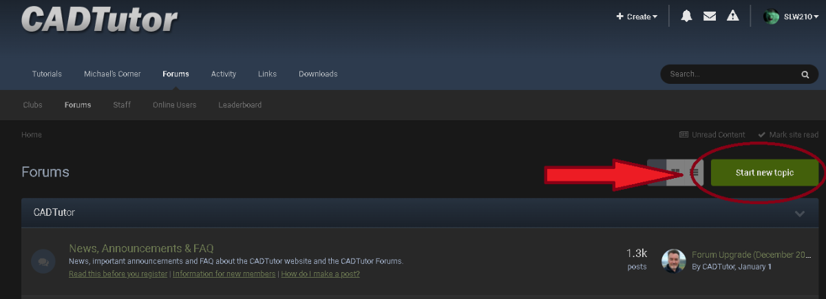

SLW210 Posted February 4, 2022 Share Posted February 4, 2022 I created a new thread in the AutoCAD Drawing Management & Output Forum. Can you post an image of the files in the folder? Are you sure one of the files isn't just a .bak? To create a new thread click the green "Start new topic" button, near the top right of most forums here. 1 Quote Link to comment Share on other sites More sharing options...

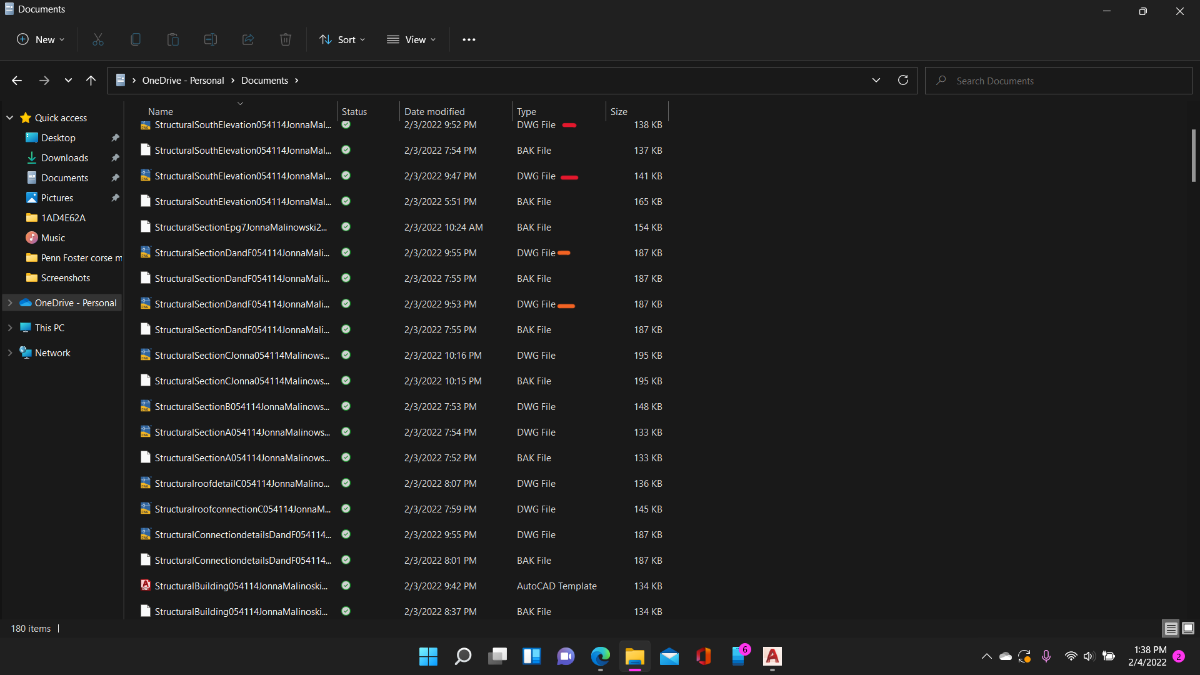

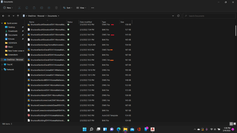

JonnaMcSki Posted February 4, 2022 Author Share Posted February 4, 2022 Hello ReMark and SLW210, First, thank you for pointing out the "Start new topic" button. I have now found it. Second, I think will help I'm new to pc world so I hope this is what you're requesting. In the screenshot I have marked the ones I'm talking about. There were more but I had to clean some of them out, it was too hard to keep track of which are the correct ones and which are not. Quote Link to comment Share on other sites More sharing options...
ReMark Posted February 6, 2022 Share Posted February 6, 2022 (edited) I can barely read that screen shot and I am wearing my glasses. LOL! So, you have the same drawing, saved at four different times or is it (the red marks), two drawings saved at two different times. It looks as though you are saving the drawings to a folder named "Documents". Is that correct? BTW... are you running AutoCAD on a Mac? I ask because if you are then that would explain what you are seeing. Found this online: "When saving a drawing in AutoCAD for Mac, instead of overwriting the existing file, a copy is created with an incremental number appended to the file name. Multiple copies of the same drawing are created, one for every time the file was saved." Edited February 6, 2022 by ReMark Quote Link to comment Share on other sites More sharing options...
SLW210 Posted February 7, 2022 Share Posted February 7, 2022 Is this just on One Drive? A network drive? Quote Link to comment Share on other sites More sharing options...

Dahzee Posted February 7, 2022 Share Posted February 7, 2022 Could it be to do with versioning being turned on in Onedrive for Business? Quote Link to comment Share on other sites More sharing options...
Steven P Posted February 8, 2022 Share Posted February 8, 2022 Try saving to a normal location as a test, say the desktop and not one drive. Some of our systems will create a new copy everytime it is saved as a version control even, for example if you saved the drawing before lunch, keep working on it after lunch, then save and close at home time..... 2 versions for the 1 set of changes. Normal file locations such as the desktop don't do that.... so worth checking if it is al drives or just your onedrive Quote Link to comment Share on other sites More sharing options...
