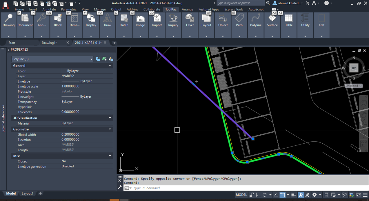

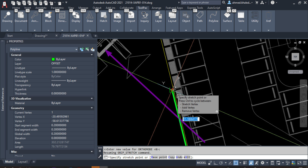

I having a problem with filleting 2 polylines it show the error (non-coplanar) also I Set Elevation = 0  and when i select 1 of poly lines the x,y vertex it changed to 3D (X,Y,Z) as shown in attached screenshots
Thanks in advance

I already Try Flatten, the z value (Elevation=0) & the Polylines are 2D Polylines (as shown in the attached drawing)

The green line is also curious in its make-up. The corner curves are parts of an ellipse, and the whole line is listed as an lwpolyline even though the vertices are at varying elevations. perhaps it has been twisted and it does not seem to respond to flatten.
17 minutes ago, eldon said:

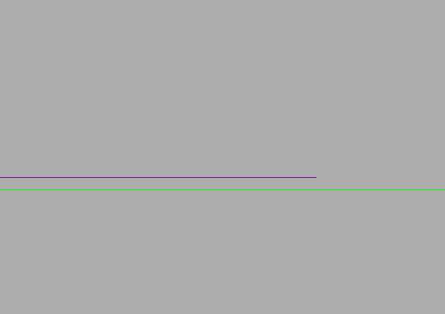

The green line has a varying elevation of -0.00000zzz, which you clearly see from a Front view.
I Make Elevation=0 with presision = 0.00000000 and still have the same problem
It is in a world of its own. It IS at zero elevation in a UCS which is not parallel the the world UCS.
You must twist it back to the world UCS, and I am not sure how you would do that.
I got a way to do it. First of all set up a UCS based on the green polyline. Then make a block of the green line in that UCS.
Then change back to World UCS and insert the block. Place it and make sure the elevation is 0. Now Fillet works.

Thank You Very Much it works perfectly
