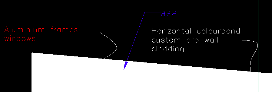

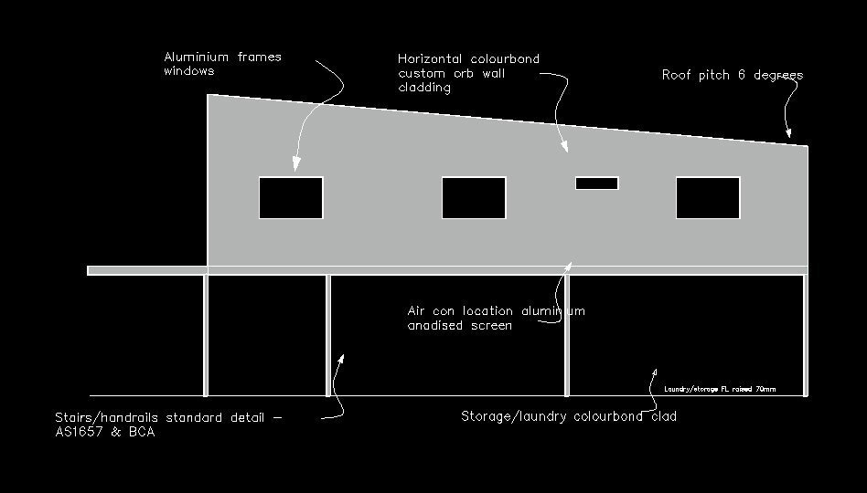

JimB Posted February 14, 2022 Share Posted February 14, 2022 I'm using AC 2020 computer has graphics card accelerated. DWG drawing related to attached layout. (Nth elevation) there are arrows (as blocks) used to identify items. Early on I flattened all of them... I cant bring any forward ... or ... to the front... So that when I print they are visible. I've tried pretty much everything I can read or source to rectify the issue, over last 5 days. Without success. Ive exploded them - no result Ive used 'DRAWORDER' - no result Ive made changes to graphics card no result I'm exasperated and run out of topics to read to try and resolve.. Any solution be appreciated. The attached file has been stripped back from over 30mg of detail to 2.7 41512895_Cadforum-Floorplan03(Residence0102).dwg Quote Link to comment Share on other sites More sharing options...
SLW210 Posted February 14, 2022 Share Posted February 14, 2022 What needs to be brought to the front? I don't see anything that is over anything else. What exactly isn't plotting correctly? Quote Link to comment Share on other sites More sharing options...
JimB Posted February 14, 2022 Author Share Posted February 14, 2022 The arrow and lines ... cant bring them forward (top) Quote Link to comment Share on other sites More sharing options...
SLW210 Posted February 14, 2022 Share Posted February 14, 2022 They are not on the same plane and not 2D Wireframe in Viewport. Best would be to put them in Paper Space Quote Link to comment Share on other sites More sharing options...
JimB Posted February 14, 2022 Author Share Posted February 14, 2022 Yes thanks ... I can do that and will as the easy the option. But it doesn't resolve what i thought a very simple issue... to bring to front..? So what your saying 'SLW210' is ...(the line was actually made as a spline...) can not be pulled to the front? Because it was/is a spline ? This it the reason ? Just trying to understand what I did wrong. In previous drawings I've not had the problem doing pretty much the same. Quote Link to comment Share on other sites More sharing options...

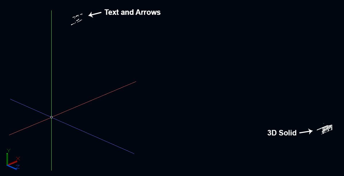

Cad64 Posted February 14, 2022 Share Posted February 14, 2022 32 minutes ago, JimB said: Yes thanks ... I can do that and will as the easy the option. But it doesn't resolve what i thought a very simple issue... to bring to front..? So what your saying 'SLW210' is ...(the line was actually made as a spline...) can not be pulled to the front? Because it was/is a spline ? This it the reason ? Just trying to understand what I did wrong. In previous drawings I've not had the problem doing pretty much the same. The problem is that your arrows and text are far behind the 3D solid, which is basically a wall that's blocking everything behind it. I went into model space and moved the arrows and text in front of the object and now they display correctly. When working with 3D objects, it's better to add text in paper space to avoid these kinds of issues. 1 Quote Link to comment Share on other sites More sharing options...

Cad64 Posted February 14, 2022 Share Posted February 14, 2022 4 hours ago, JimB said: I think the issue is the arrows (made with a spline) are not wire frame ... so cant pull forward or push back ... only thing I can come up with as reason... The spline is not the problem. The problem is that the text and leaders are physically behind a wall. Draworder can't change the fact that they are behind a solid object. You have to move them in front of the solid object or put them in paper space. 1 Quote Link to comment Share on other sites More sharing options...
SLW210 Posted February 14, 2022 Share Posted February 14, 2022 As I stated, they are not on the same plane, so they need moved in Model Space to the same plane or put the text, splines and arrows into Paper Space. As shown in Cad64's image, they are far from each other. Going to 2D wireframe just keeps the solid from blocking the arrows. 1 Quote Link to comment Share on other sites More sharing options...

SLW210 Posted February 17, 2022 Share Posted February 17, 2022 Your drawing is not flattened for starters, hence, not on the same plane. Otherwise what you want will work. I do everything you do, blow-ups and everything else and still use paper space annotation, I find it easier than if I had annotations I don't need in my blown-up area. I get it, you like to work the way you work and that's fine for you, but now you see the error in that way, under certain circumstances, you just need to adjust when you hit a snag, that's all. I know several fields that still do everything in model space and it works fine for certain things, items on different planes isn't really one of them. AutoCAD is working as intended and I doubt they will make a change to remedy this as you would want, but you never know. Try going and adding it to the wishlist at AUGI. Quote Link to comment Share on other sites More sharing options...
