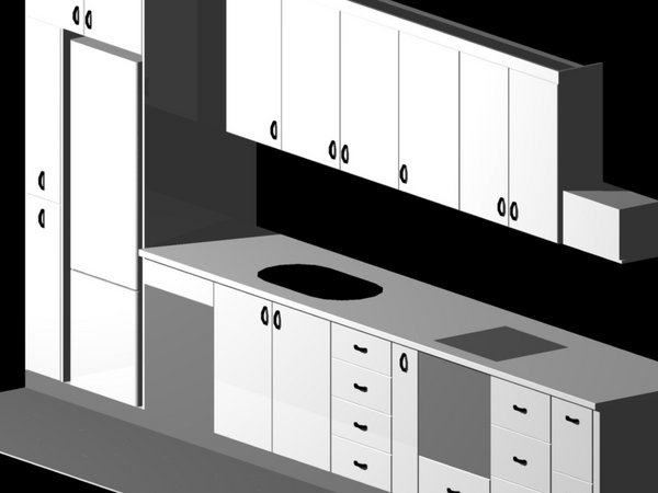

gesaugen Posted August 10, 2007 Posted August 10, 2007 Hi ppl! I've encountered a strange bug in Acad while trying to render a 3D drawing of my kitchen. It seams like Acad looses a connection btw shapes and it+s dimensions, shown on this screen capture here: now, the problem is that I can't render anymore, no matter what I do. It just makes my screen black after rendering, like I was rendering a blank screen... anyone has an idea how to fix this? Quote
tzframpton Posted August 10, 2007 Posted August 10, 2007 Dimensions will never render. I don't know about the black screen.... there could be several problems. Can you upload the file? :wink: Quote
SLW210 Posted August 10, 2007 Posted August 10, 2007 Why do you need the dimensions in your render? Quote
gesaugen Posted August 10, 2007 Author Posted August 10, 2007 Why do you need the dimensions in your render? I've meant by dimension a length and hight of objects, and not a graphical option to show dimension... here's the file: http://rapidshare.com/files/48198005/kuhinja_2.zip another thing: a drawing is associated with textures in .jpg files, but i don't know how to paste a texture over a solid, and that a texture is there permanently, no matter on who's PC it's been watched... Quote
Cad64 Posted August 10, 2007 Posted August 10, 2007 First thing you need to do is turn off the sun. Unless your kitchen is outside in the backyard, the sun should not be on. Second thing you need to do is add at least one light to your scene. Try adding a spotlight. I did these two things with your model and it rendered fine. There were no textures included in your zip file, but here is the result I got: Quote
gesaugen Posted September 12, 2007 Author Posted September 12, 2007 back from vacation... anyway, I've figured out what was wrong: A drawing itself has become corrupted in some way, so I've copy a content of drawing and paste it on new blank sheet... now everything works fine... still, imho, ACAD is pretty buggy piece of software Quote
