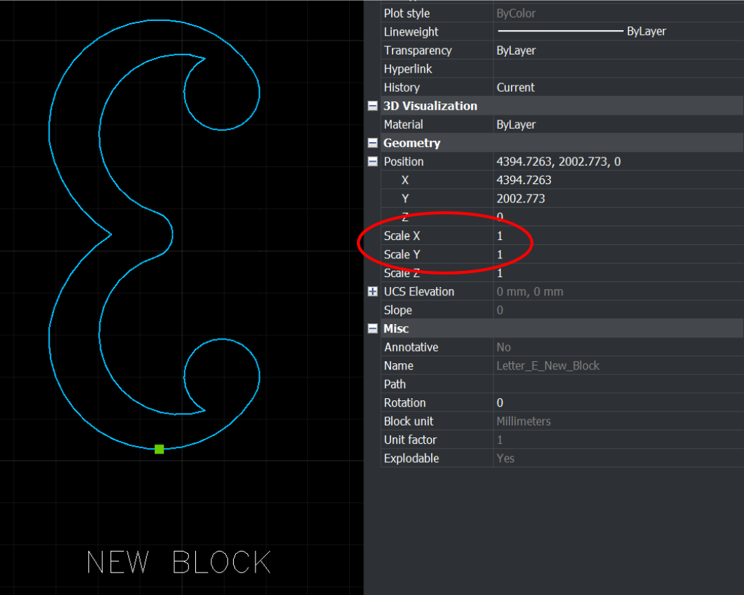

Hi PJ01,
You have it correct, you now have a block which you can scale separately in different axis.
Your block is dynamic but that doesn't matter for this instance it still works.
Just select the block and in the Properties palette, adjust the Scale X and Scale Y as you require (see attached PNG).
In your file I exploded the block and turned it back into an ordinary block and adjusted both the X and Y values as you can see.
e-block.dwg
