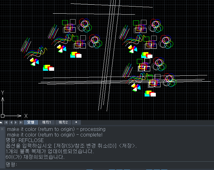

thanks in advance for help me but :
Command: (LOAD "C:/Users/Utente/Dropbox/Lavoro/backup/AUTOCAD/Lisp/Layer/classify.lsp") ; error: extra right paren on input
all this requests, because i  want view all drawings elements in a temporary color (purple) and when i edit a block i want view real colors.
you could do something that remembers the original color of the elements before editing the block.
When finished of edit block and come back to drawing i see all again in purple color (temporary color)
Edited by jim78b
not happen nothing, i want thet it work even inside blocks... thanks in advance

For such a purpose, there is a way to implement it without using a layer.
This Lisp uses hyperlinks.
1. input "0" outside a block before work, all blocks and not blocks store [color, line type, line type scale] in hyperlinks.
    then make it all, purple and continuous and linetypescale 1.0.
2. input "`" in block editor, it will return to the original color and delete hyperlinks
    If you type 0 before closing the block editor, all objects in the block return to purple.
    It doesn't matter if you input 0 outside the block editor.
; make it color - 2022.03.15 exceed
; this lisp use object's hyperlink property
; command list
; ` = make it color (return to origin) leftside of "1" key
; 1 = make it red
; 2 = make it yellow
; 3 = make it green
; 4 = make it cyan
; 5 = make it blue
; 6 = make it magenta
; 7 = make it white
; 8 = make it gray
; 9 = make it light gray
; 0 = make it purple
(defun c:` () (ex:mic) (princ)) ;make it color (return to origin)
(defun c:1 () (ex:mip 1) (princ)) ;make it red
(defun c:2 () (ex:mip 2) (princ)) ;make it yellow
(defun c:3 () (ex:mip 3) (princ)) ;make it green
(defun c:4 () (ex:mip 4) (princ)) ;make it cyan
(defun c:5 () (ex:mip 5) (princ)) ;make it blue
(defun c:6 () (ex:mip 6) (princ)) ;make it magenta
(defun c:7 () (ex:mip 7) (princ)) ;make it white
(defun c:8 () (ex:mip 8) (princ)) ;make it gray
(defun c:9 () (ex:mip 9) (princ)) ;make it lightgray
(defun c:0 () (ex:mip 200) (princ)) ;make it purple

hello i test the lisp, is very slow...and seem not work for all blocks, as in attached figure you see the green blocks and title block that doesn't change its color.
the ' not return on the original state, i don't know if i must reload the lisp...

(princ "\n command [ ` - return / 1 - red / 2 - yellow / 3 - green / 4 - cyan / 5 - blue / 6 - magenta / 7 - white / 8 - gray / 9 - light gray / 0 - purple ]")
1. can edit nested block also, this is Kent Cooper's code.
2. can edit 1 select option.
0 - 1 selection
00 - all of drawing.
so, in front of REFEDIT MODE or inside of REFEDIT MODE also can do this.
If this Lisp is running on heavy drawings, you can split it up and run it.
3. Exceeding the capacity of xdata seems to be a different problem.
This Lisp will not hit the limits of xdata because it writes "color, line type, line type scale" in one line of text.
10 hours ago, BIGAL said:
exceed welcome to use this
Have you looked at ( setq colnum (acad_colordlg 1) pick any color probably what I would use saves need more defuns.
or
(if (not AH:Butts)(load "Multi Radio buttons.lsp"))
(if (= but nil)(setq but 1))
(ah:butts but "V" '("Choose a color" "yellow" "green" "cyan" "blue" "magenta" "white" "gray" "light" "gray" "purple"))
; the variable BUT inside the code holds the button selected value can use that for this post
thank you. I'll study DCL because I've only experienced merging divided .dcl files into one .lsp only once. You seem to have made it easy to understand.
sorry i am confused now, what is the right listing? if I edit a block in place those outside become purple I hope?
one stroke key is for ONE
double stroke key is for ALL
1. before REFEDIT
00 - make all drawing purple
2. in REFEDIT
` -  make it original color (1 block)
3. after REFCLOSE
0 - make it purple (1 block)
As you've experienced, this routine or change layer thread's routine takes time.
so if it's simply an invisible problem for instant work only,
Lisp that changes the background color with a "tab key" might be better.
;; Modified from the original by Lee Mac 13 JAN 2019
;; cadtutor.net/forum/topic/66670-cursor-color-changing-lisp/
;; Post 5
;; Cycles the background from black (000), thru all shades
;;   of grey (250/251/8/252/253/9/254) to white (255).
(defun c:BCTAB ( / d l )
    (setq l '(000 3355443 5987163 8421504 8684676 11382189 12632256 14079702 16777215)
          d  (vla-get-display (vla-get-preferences (vlax-get-acad-object)))
    (princ "\nPress TAB to cycle BACKGROUND colors <done>: ")
    (while (equal '(2 9) (grread nil 10))
        (vla-put-GraphicsWinModelBackgrndColor d (car (setq l (append (cdr l) (list (car l))))))
or locked layer fading control command
laylockfadectl, -90 (can see like unlocked layer) ~ 90 (can't see anything)
Edited by exceed
Later i will try thanks a lot . Important that when use refedit object outside are purple .
