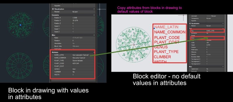

I'm trying to make an auto lisp which will help me with updating my blocks default attributes.
Unfortunately I can’t find the solution - so I hope that someone can help me with this problem.
I’m a landscape designer and I made tree blocks for my projects. I used export and import attributes function in CAD to update all attributes values in my drawing. But I would like to have those values as default. Auto lisp code should copy every values from attributes tags from block in drawing to default attributes values of this block.

@devitg In attachment is example file with plant blocks. There are 5 of them. I plan to have 200 plant blocks. Like you can see I drawing I added values to attributes to blocks. When you edit block you will see that blocks don't have default values in attributes.
I would like to use lisp to copy vales from values in attributes in blocks in drawing to default values in attributes of this block.
I would like to use then WBLOCK to save those blocks in folder to use it in other project - without to have complete attributes again.

Back to question using Bedit then dbl click an attribute fill in default value and Bclose and save, then insert block the default prompt value should be there.
It is feasible to get at block attributes in the block table and set default values to prompt.

My way to do it .

(defun copy-att-to-empty-block (/
ACAD-OBJ
ADOC
BLOCK-
BLOCK-OBJ
BLOCK-OBJ-ESC-X
BLOCK-OBJ-ESC-Y
BLOCK-OBJ-ESC-Z
BLOCK-OBJ-NAME
BLOCK-OBJ-ROT
BLOCK-SS
COUNT
MODEL
NEW-BLK
NEW-BLK-ATT-LIST
NEW-BLK-ATT-LIST-QTY
NEW-BLK-PT
OLD-BLK-ATT-LIST
  (VL-LOAD-COM)
  (SETQ ACAD-OBJ (VLAX-GET-ACAD-OBJECT)) ;_ el programa ACAD
  (SETQ ADOC (VLA-GET-ACTIVEDOCUMENT ACAD-OBJ)) ;_ el DWG que esta abierto-
  (SETQ MODEL (VLA-GET-MODELSPACE ADOC))
  (prompt "\nSelect the BLOCK to copyfrom [rigth click to end ]  ")
  (while
    (/=(setq block-ss(ssget "_:S+." (list(cons 0 "INSERT")(cons 8 "*"))))nil)
    (setq block-(ssname block-ss 0))
    (setq block-obj (VLAX-ENAME->VLA-OBJECT block-))
    (setq block-obj-name(VLA-GET-NAME  block-obj))
    (setq new-blk-pt
           (getpoint (strcat "\n pick the point where to Insert the < " block-obj-name " >"))
          ) ;_  setq new-blk-pt
    (setq block-obj-esc-x (vla-get-XScaleFactor block-obj))
    (setq block-obj-esc-y (vla-get-yScaleFactor block-obj))
    (setq block-obj-esc-z (vla-get-zScaleFactor block-obj))
    (setq block-obj-rot (VLA-GET-ROTATION block-obj))
    (setq new-blk
           (vla-InsertBlock model (VLAX-3D-POINT new-blk-pt)
             block-obj-name
             block-obj-esc-x
             block-obj-esc-y
             block-obj-esc-z
             block-obj-rot
             ) ;_  vla-InsertBlock
          ) ;_  setq
    (setq new-blk-att-list (G-ATT-LIST/OBJ new-blk))
    (setq new-blk-att-list-qty (Length new-blk-att-list))
    (setq old-blk-att-list (G-ATT-LIST/OBJ block-obj))
    (setq count 0)
    (repeat new-blk-att-list-qty
      (VLA-PUT-TEXTSTRING
        (nth count new-blk-att-list)
        (VLA-GET-TEXTSTRING (nth count old-blk-att-list))
        ) ;_  VLA-PUT-TEXTSTRING
      (setq count (1+ count))
      ) ;_  repeat
    ); end delwhile
  );end copy-att-to-empty-block
