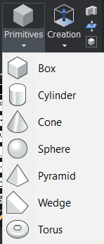

Yes, that would be considered solid modeling.  The full version of AutoCAD would be required.  BTW... primitives are included in AutoCAD.

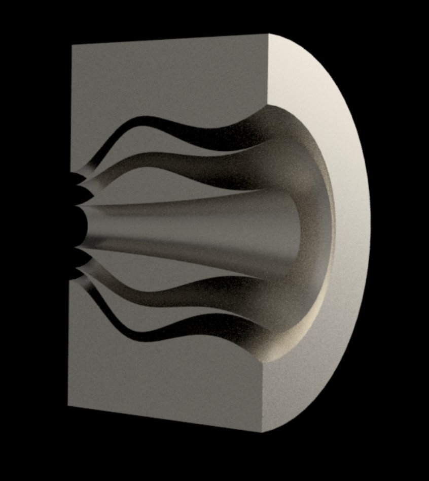

I will be modelling waveguides. Here is an example..
Ok, well as I mentioned before, there are many programs you could use for this. Fusion360, Inventor, Solidworks, Rhino or FormZ would all be good programs to look at. Fusion360 and FormZ both have free versions you can use, but I don't know if you can get them in a Linux or 32 bit version. You would have to do some research and find out.
