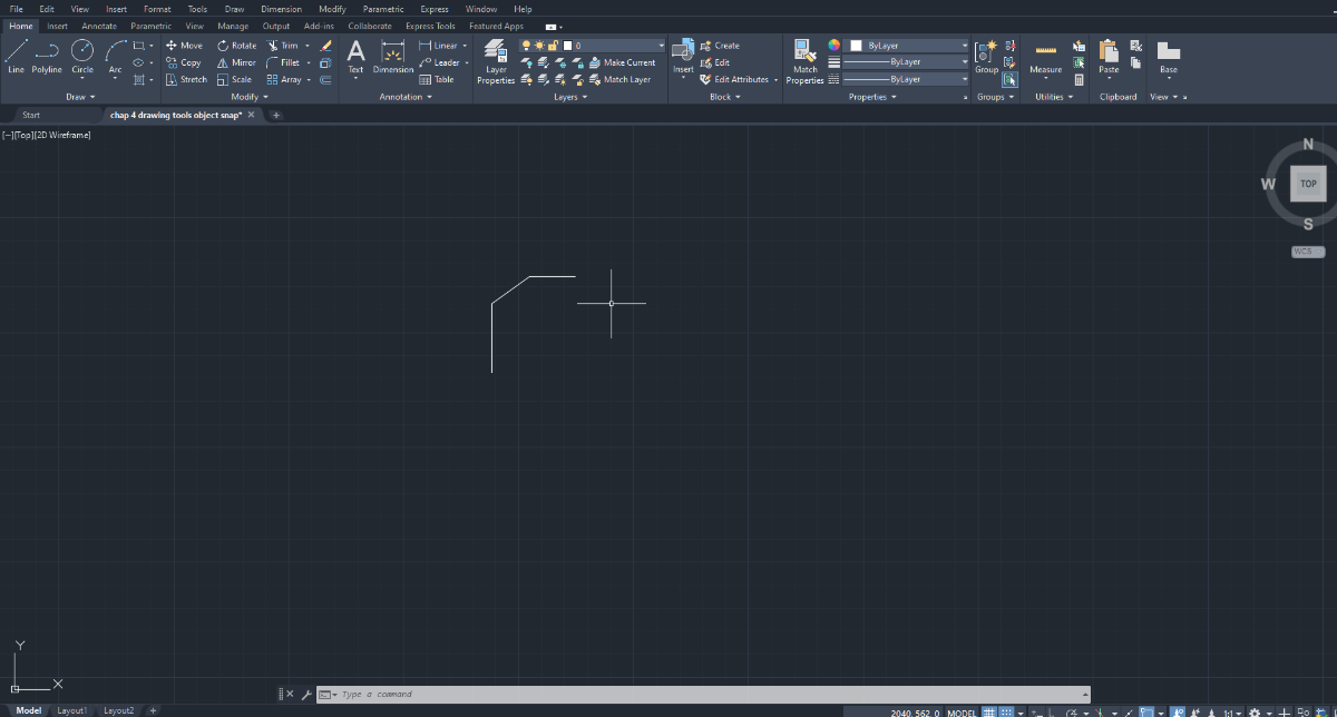

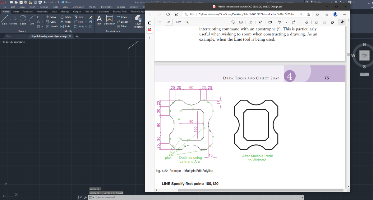

Drawing an arc at 60 photos attached
bruce lee
