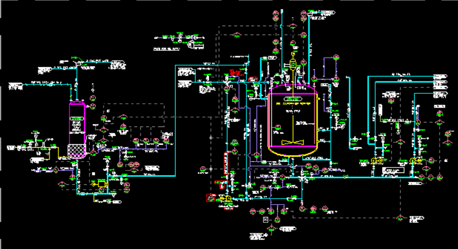

Samr1979 Posted April 26, 2022 Share Posted April 26, 2022 How do you show P&ID in Revit? Do you still draw them in 2D, or do you just show them in 3D like an ISO view? What does everyone do? Quote Link to comment Share on other sites More sharing options...

ReMark Posted April 27, 2022 Share Posted April 27, 2022 (edited) On 4/26/2022 at 7:43 PM, BIGAL said: Watched a demo by Autodesk a couple of years ago, was P&ID I think drawing pipes etc in 3d just nominated length and directions etc did elbows, valves etc all in 3D. For me looked good as I am Civil Engineering most time That would not be considered a P&ID. That would be a piping isometric. "P&IDs are a schematic illustration of the functional relationship of piping, instrumentation and system equipment components used in the field of instrumentation and control or automation. They are typically created by engineers who are designing a manufacturing process for a physical plant." Edited May 25, 2022 by ReMark 1 Quote Link to comment Share on other sites More sharing options...

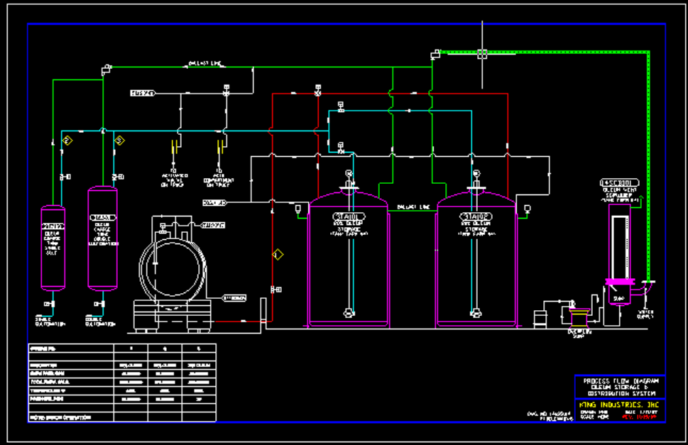

ReMark Posted April 27, 2022 Share Posted April 27, 2022 (edited) Here is an example of a P&ID. BTW... The first drawing to be created when considering a new process is the Process Flow Diagram. This is then fleshed out via the creation of the Process Piping and Instrumentation Diagram (PP&ID or P&ID). With the advent of 3D piping programs such as PLANTworx, AutoPLANT and AutoCAD Plant we can now create a 3D drawing of the process piping and equipment and from that drawing we can extract both a P&ID as well as an isometric piping schematic. Edited April 27, 2022 by ReMark 1 Quote Link to comment Share on other sites More sharing options...
ReMark Posted April 27, 2022 Share Posted April 27, 2022 (edited) An example of a Process Flow Diagram. Edited April 27, 2022 by ReMark 1 Quote Link to comment Share on other sites More sharing options...
