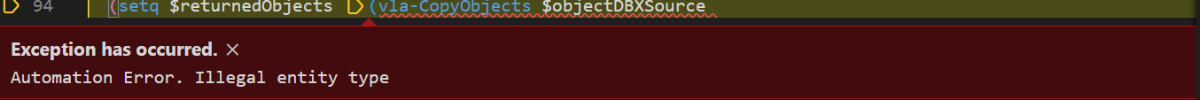

guys hopefully someone can enlight me because i'm really stuck at this moment.
I made this code so far with the following help file https://help.autodesk.com/view/OARX/2023/ENU/?guid=GUID-D9E0A89C-2D81-4141-8B88-B9AC6EAABD62:

It gives an error on (vla-CopyObjects
axdb24enu.tlb input-drawing.dwg output-drawing.dwg
Edited by Revnixcad
i get the following error with vla-CopyObjects function
Automation Error. Illegal entity type
