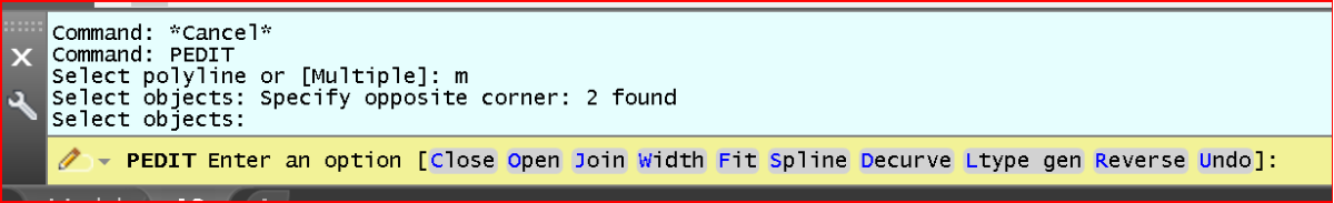

itacad Posted May 8 Share Posted May 8 Hi, I can't perform the simple operation described, that is, if two polylines are at the same height and the vertex of one polyline is in front of that of the other polyline, it does not seem possible to make them become a single polyline (the same operation succeeds instead with simple lines). Greetings Quote Link to comment Share on other sites More sharing options...
Dadgad Posted May 9 Share Posted May 9 (edited) Have you tried using the JOIN command or PEDIT command? Either of them can do it. Edited May 9 by Dadgad Graphic added Quote Link to comment Share on other sites More sharing options...
SLW210 Posted May 9 Share Posted May 9 Overkill will do that. Just check the box for "Combine co-linear objects that partially overlap". 2 Quote Link to comment Share on other sites More sharing options...

Dana W Posted May 9 Share Posted May 9 On 5/8/2022 at 10:14 AM, itacad said: Hi, I can't perform the simple operation described, that is, if two polylines are at the same height and the vertex of one polyline is in front of that of the other polyline, it does not seem possible to make them become a single polyline (the same operation succeeds instead with simple lines). Greetings The end points have to be on exactly the same point for JOIN to work. Quote Link to comment Share on other sites More sharing options...
SLW210 Posted May 9 Share Posted May 9 5 hours ago, tombu said: The fillet command is another option. Using Shift+pick ensures Radius = 0. Fillet R=0 doesn't work here. Always thought it strange Join works on Lines that overlap, but not PLines. I suppose you could explode the PLines to Lines, Join them, then Pedit them. Overkill is pretty quick though. Quote Link to comment Share on other sites More sharing options...
tombu Posted May 9 Share Posted May 9 1 hour ago, SLW210 said: Fillet R=0 doesn't work here. Always thought it strange Join works on Lines that overlap, but not PLines. I suppose you could explode the PLines to Lines, Join them, then Pedit them. Overkill is pretty quick though. Weird, it's always worked for me. Just tested it again both with PEDITACCEPT set to 0 and set to 1 and it worked both times? Are you sure you had them at the same height same as itacad? Quote Link to comment Share on other sites More sharing options...
itacad Posted May 10 Author Share Posted May 10 Thanks everyone for the answers! The only answer that worked (hoping you didn't make any mistakes) is that of Dana W. If the only solution is to bridge the distance between the polylines, joining the vertices manually and then launching the join command ... unfortunately it doesn't help Greetings Quote Link to comment Share on other sites More sharing options...
