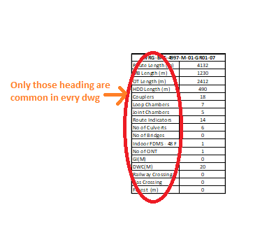

I have ole object and I want to export that in an excel sheet, and thing is that there is nearly 1000 dwg's and every dwg has a different name and different calculation, is any way to save those information in excel

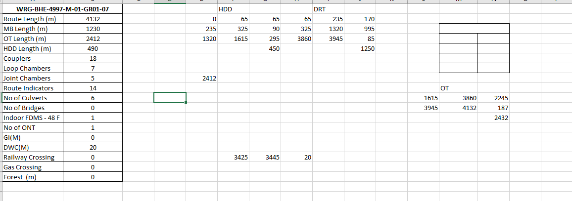

Use oleconvert command it open a XLS .  Search for the folder where  it is located by SAVE AS  . I do not know if you can do it  for 100's dgw at once
I got it from a Google search
Hoja de cálculo en OLE.xlsx

i think this command is only for open dwg, but I have 1000 of dwgs having ole object
