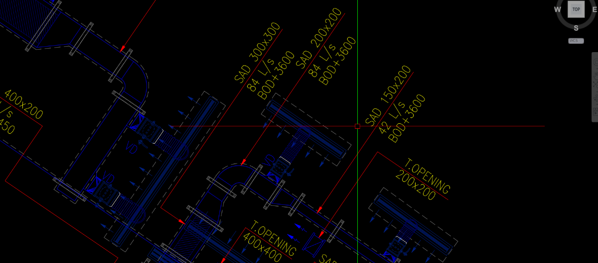

Automatic Qleader for text
Ajmal
 Share
1.    select text
2.    (setq p1 (get point))
3.    entmake Qleader from p1 to test boundin box
4.    (From offset some distance from text bounding box)
    (Leader same as attached picture.)
    (From text left or right no issue)
    (if straight 2-point qleader or 3 point)
image.thumb.png.2368c36bece23e5db20a42a02de80493.pngimage.thumb.png.5fde2dc5b79b2efa2adbf924dc97850e.png
Edited by Ajmal
attach more picture

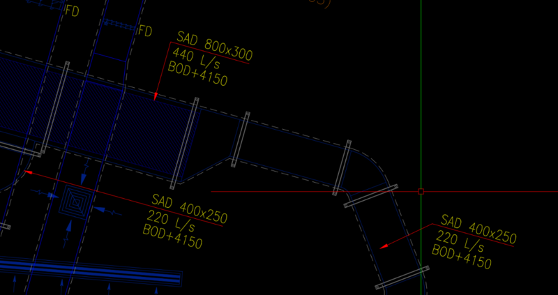

how about this?
command : ELEAD
Edited by exceed
This is exactly what i expect
Thanks, exceed
but i have request for this
1. Can you do this for ucs also?
2 as attached drawing there is one ore item is coming with leader so vertical text i cannot arrange (i think that is landing point)
TEST.dwg
Edited by Ajmal
explanation

        (vla-endundomark doc)
(MLEAD, this is for show examples in several cases, ELEAD will work the same way for 1 text)
My English is not good, so I don't know what vertical arrangement means.
I understand that you want the text to be rotated horizontally or vertically.
original text : 0 ~ 45 deg -> 0 deg
original text : 45 ~ 135 deg -> 270 deg
like this, they were aligned to the nearest side. is this right?
and then Changes ucs vertically to the visible screen while the origin is moved & the z-axis is rotated.
If you want, the UCS has only the origin moved and you want to be perpendicular to the direction of UCS rotation,
Add a ; before all (command "UCS" "W") and (command "UCS" "P").
like this gif
Edited by exceed
wow. really it genuinely nice one
i add some rotation off for this

Let me explain
I will select text and existing leader its need to make the new leader. existing will be modified or delete
from existing leader, it will take the starting point as a "basept"
all same as your code
TEST.dwg
; ELEAD ucs modified ver. - 2022.05.19 exceed
; https://www.cadtutor.net/forum/topic/75182-automatic-qleader-for-text/
; If you select text and click a point, a LEADER is created
; that connects the underline of the text.
; Command List
; ELEAD - Make 1 Leader
; MELEAD - Make multiple leaders. towards 1 point
; ELEADRESET - Reset property values
; - This is a minor modification of Lee Mac's StrikeThrough Text ( http://www.lee-mac.com/strikethrough.html )
; - Created on the current layer. by current color
; - Individual Arrow Size is set without modifying STYLE.
; - works for rotated text.
; - Leaders are created from the left or right side closest to the base point.
; - whenever you open a drawing, you have to set the environment the first time.
; - When Pick is difficult, you can get help from a crossing selection.
; - If no selection is made, it is terminated.
; - To make it easier to draw a horizontal line, getpoint based on an imaginary center point. (ELEAD Only)
; - If multiple texts are selected, only one of them is randomly selected. (ELEAD Only)
